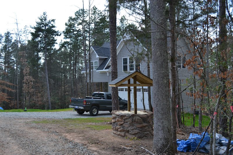

We are thinking about having a wishing well built to cover our well head instead of using the fake plastic rock that the builder provided. I have two concerns. First is that it might make replacing the well pump difficult. Second is that it might make drilling the well deeper difficult to impossible if this ever needed to be done. Obviously at a minimum the roof would have to be removed to re-drill the well, but I am wondering if the stone base would be in the way. Anyone have any experience or knowledge on this subject? I might call the well guy that our builder used, but I am guessing any well guy is going to tell you not to build something like this.
We are thinking something similar to this:

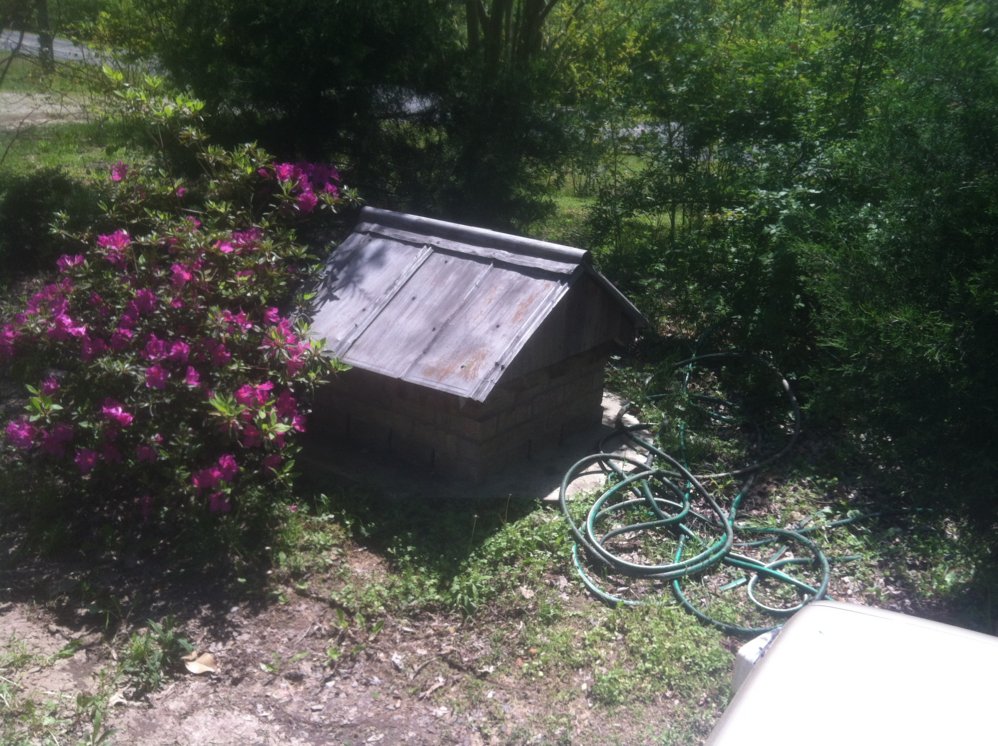

Here's mine and it's super simple. I can remove it myself. Was my own design and the envy of the neighborhood. I'll let you borrow the design for a six pack.:flipoff2:

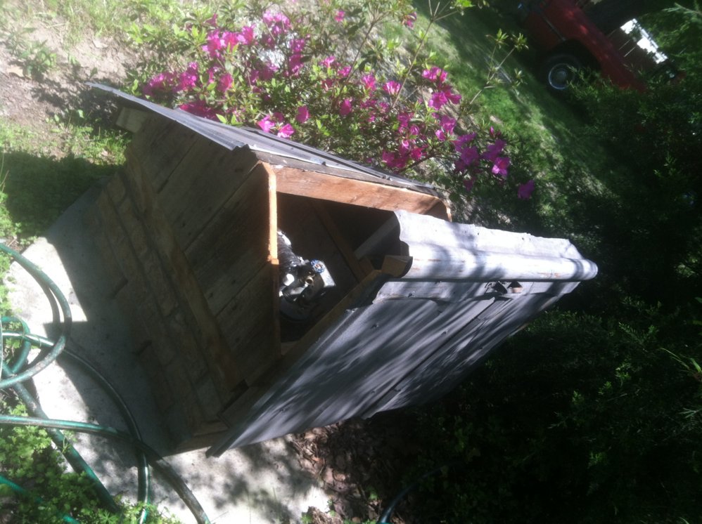

Another. I have a piece of thick insulation dedicated to put in there during the winter that I store in the pump house during summer. Also the brick foundation provided a perfect place for the "well guy" to mount his equipment to pull my well when I need it done once.

Pulling and changing a pump it shouldn't matter. Drilling deeper I'd say you have to move it cause the tower is directly behind the truck (rear of truck bed right over the hole)
There's a thread on here somewhere about this. I built mine similar to what's in the first picture. I made it so that the roof/top is removable if (make that "when") I need to service it. If I have to drill deeper, I'm going to relocate it anyway because we have a lot of iron in our water, so for me that's a non-issue.
I like the wishing well the OP posted up. That has a pretty cool look to it. However, removing all that top looks like it might be kind of heavy and a pain. How well would it insulate the well?
