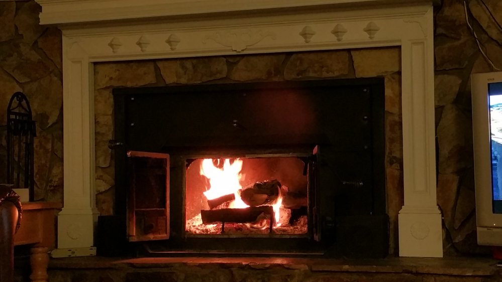

I have one. Burning it now.
I believe mine is a Porter brand insert w/ therm blower
Might be Porterlator. That's what I've got in my shop. Made here in Charlotte and very well built.
