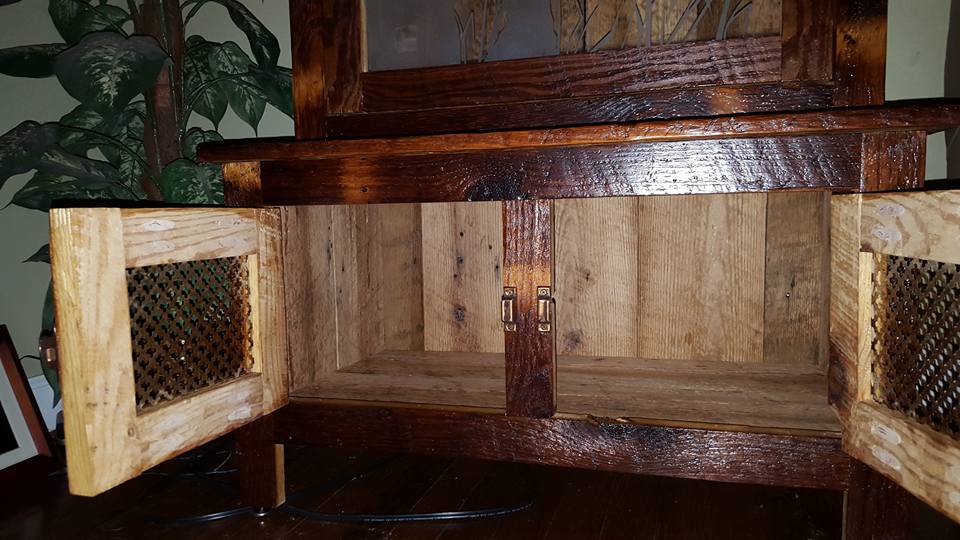

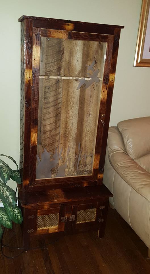

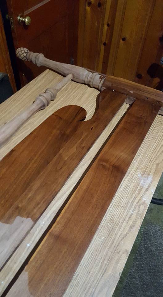

I would start by LIGHTLY wire brushing the wood. That will really bring out the patina in the grain. I would then hit it with a light round of 220 grit sandpaper...steel wool will take forever to get it smooth. Remember, the tung oil will bring out more color in the wood and really enhance the color...particularly any reds you might have. Oiling wood is a really long process if you want to do it right. Softer woods (pine, poplar, etc) will suck up a HUGE amount of oil...like HUGE...just keep rubbing it on. I recommend allowing at least 8 hrs dry time between coats and like to stretch to 12 or longer. Once you see it start to harden, start 'buffing' between the coats to bring out the shine. For hardwoods, go 8 coats for decent protection and a few more for soft woods. I have done both of these this year. This gun cabinet is 1880s pine and the pineapple bed is mid 1800s mahogany...neither one have any color (stain) added. The only difference in the finished and unfinished is just the oil...

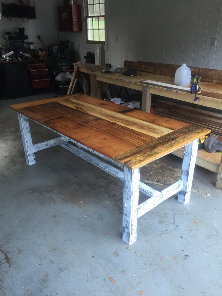

I decided to be cheap and use the BLO that I already have. Since the thing is made from scrap boards, might as well keep the theme going. I did purchase some ebony stain for the base, the plan is to antique it with a white top coat. Here it is after one coat of each.
2 parts BLO
1 part varnish/ polyurethane
1 part mineral spirits.
Mix it in a mason jar when do a few coats when you get the jar about half empty top it off with more varnish, and do a couple final coats.
You just made a "tung oil finish"
I tried some minwax paste wax on a sample piece, and the surface was not smooth enough to get an even application. So, it looks like I will be using some type of poly this weekend after the last coat of BLO has a few days to soak.
