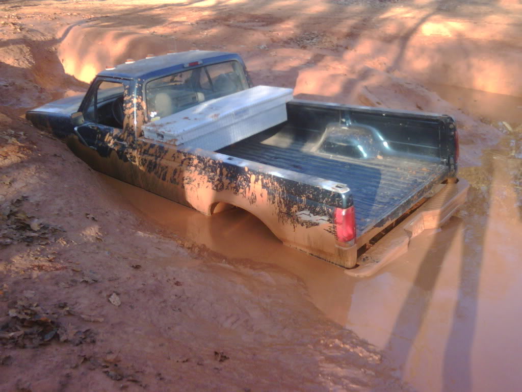

well heres a little of mine....swamped the motor at falls dam....luckily no hydro lock

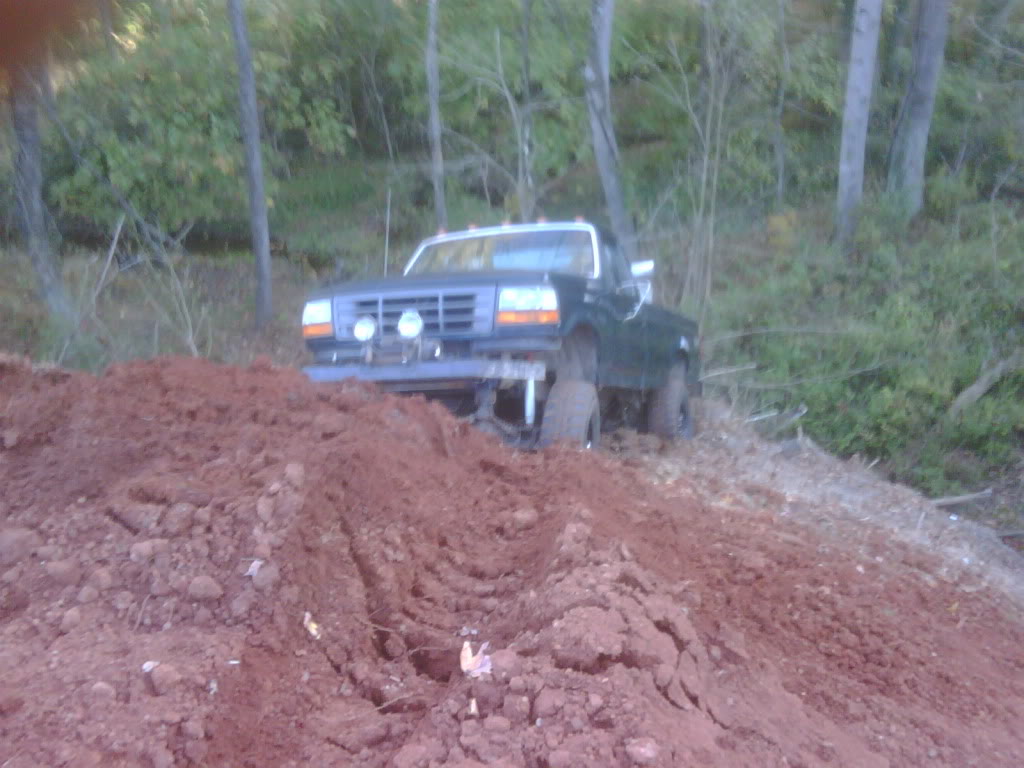

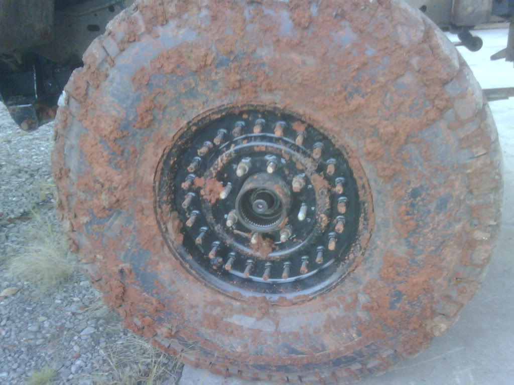

this happened on upper daniel....destroyed a ring gear,not mine
using my front bumper under his reese hitch to support it.

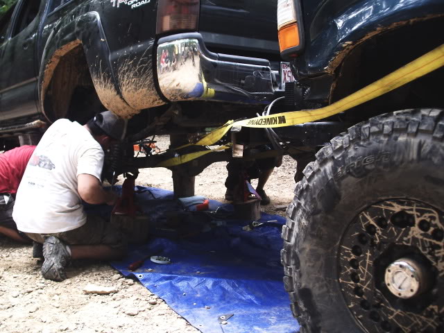

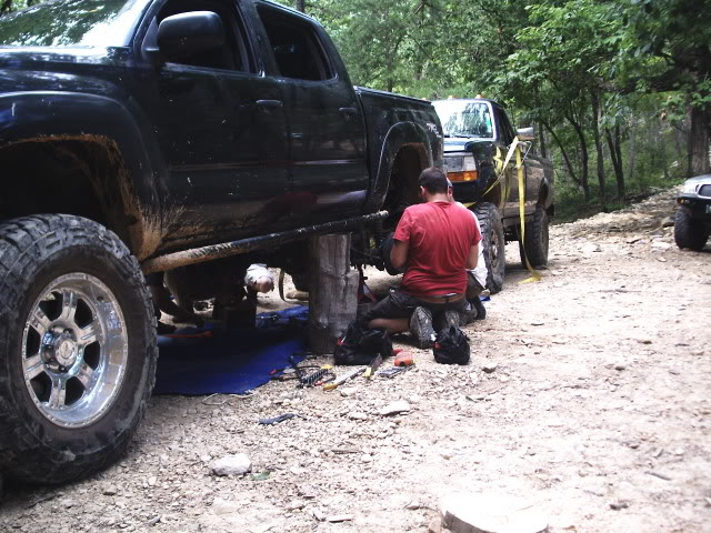

A few years ago at tellico. This was a friends truck I was riding with. It was a very heavy 78 Bronco on 42's.
Day one. Just past guardrail at the V-notch hydraulic ram brakes end hiem. No big deal. It was just hyd assist, so still have P/S. The quickest way down is school bus. After a short way the rag joint on the steering gear box strips. That means no steering at all. Used the winch to pull the tires straight on one side a ratchet strap on the other side. Ratchet strap breaks. Use lock - unlock hubs and back up for steering. Very slow progress. Go forward 4 foot back up 2. Friend goes and brings us new joint. It's late and we tell him we will put it on and see him later at camp. We realize after he leaves that it's riveted on. We camp by the canyons at the top of schoolbus. March is a bad time to camp with no tent or blankets.
Day two. We use a screwdriver and hammer to make notches in the power steering pump and use it like a grinder to replace the rag joint. We decide to go by the canyons instead of through them. Almost roll about 100 times and run out of gas. Get some gas and steering gear box breaks. Friend takes his bronco apart and gets a ride to bring us parts. We put it on and hose will not fit. At least we have manual steering. The bolt holes on the frame that hold the gearbox on strips. Get it about 3 miles from trail one. Leave it on the mountain and hike down. Get FOOD!!! and a hotel (HOT SHOWER)
Day three. This is Monday. We call into work and know all we have to do is get it to trail one where we can get it on a trailer. We go to town and get an assortment of parts and patch it up. It has one full turn of the wheel of play, but at least it turns some. Eventually we get it on the trailer. Now we are on the TN side and need to get to NC. We took the dragon tail road with a quadcab logbed truck and 20 foot trailer. We just want to end it all! Eventually we get home in time to sleep for a few hours before work the next day.
