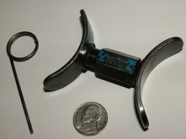

i will soon be changing the timing belt on the 3.4 in my mom's 98 4runner, and i am needing the timing belt tensioner compressor
i really hate to pay $50 for the snap-on one, or waste the time to build one, because this is one tool i know i will never need again
i cant find it listed as a loaner tool at advance or autozone
anyone near salisbury happen to have one that i could borrow for a couple days sometime while im home on my christmas break?

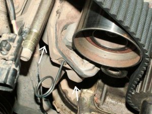

All you need to do is unbolt the tensioner, put it in the vise and use a small alen wrench to put in the hole. If you have any ques. call me (980)581-6454
ok, things like that are too simple and makes me wonder why they make a tool
thanks, makes perfect sense
