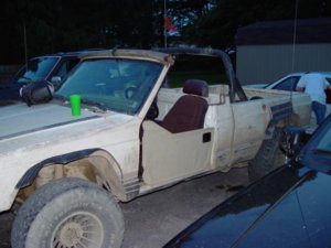

i know now that this is not what he is wanting, but interesting nonetheless
why are you wanting wrangler hinges? you can make the factory doors removable using the existin hinges.... unless ur wantin to do like hte pic above and put wrangler doors on it
