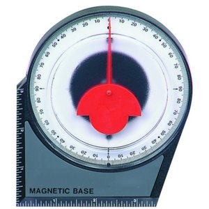

Do yourself a favor and buy one of these
angle finder.jpghttp://www.harborfreight.com/dial-gauge-angle-finder-34214.html
Now that you have those 2 measurements right you're readyt to adj. the uppers to set caster on the front wheels. Clean the top of the upper ball joint so the angle finder will sit nice and flat on it. adjust the upper arms in or out to get the angle finder to read 5, 6, or even 7 deg. positive castor meaning the upper BJ joint sits to the rear of the lower BJ or the axle is tilted back. Caster angle is what makes the jeep track straight down the road and brings the steering wheel back to center as you complete a turn. The wider the wheel and the less backspacing the better it is to have more caster to counteract the leverage they put on the steering. "Scrub radius" is a good term to Google that will help explain why the taller wider tires/wheels put more leverage on steering components.

bought me an angle finder going to look at pinion angles this evening, thanks for advice will let you know how it turns out
HELP!!! I purchased an angle finder as suggested. I removed the drivshaft checked the angle directly off the splined shaft coming from the transfer case, i also checked the angle with guage mounted to the end of the pinion shaft. I adjusted the lower contol arms so that the pinion matched the same angle as the transfer case. I even replaced both U-joints while i had the drive shaft removed. Jeep was on the ground and i had it parked on the levelest spot i have in the driveway. Reinstalled everything and went for a test drive drove around for about 20 minutes, the Jeep never offered to vibrate even once. Went to work the next morning and the vibration reappeared!!! Any suggestions? On a side note, with 3" of lift how much drop should i have on the transfercase. I have 1-1/4 of drop now, is this too much or not enough.
The amount of transfer case drop needed is really Jeep specific. I've seen people use everything from a half inch to over 1.5" like I did. I was able to drop mine to about a half inch when I got a motor Mount lift but I had vibrations with all combinations until I got a cv driveshaft. What was the angle when you measured?
Transfer case was at ~8* i adjusted the pinion to match, since i wasnt exactly on level ground i was thinking that as long as i got the 2 to match it would be ok
