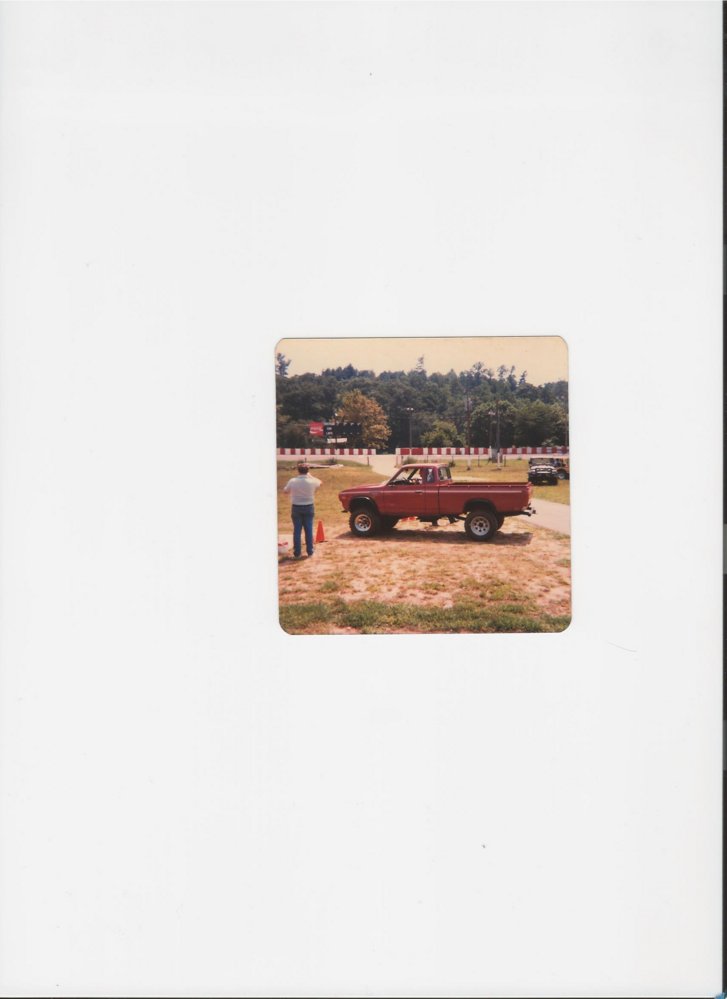

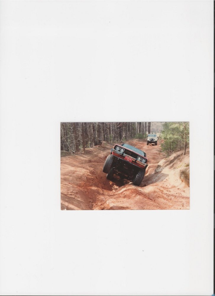

You guys quite keeping me up, I got to get up at 5am., But I had to jump on this! Hope my Scan worked! I helped convert my 77 Datsun truck, to 4-wheel dr. Seems like it was the Low kit, but mine was narrow track
D30, with 6 lug drilled lugs. I can't recall if it was drum or disc. Used the divorced dana 20, front was 4:27, to match up with Datsun's rear 4:37. As time progressed, I had a D44 rear/4:27, w-Detroit locker. 1966 odd fire Buick V6[225] & Monza 5sp. Too many other options to list. Bruce Hatton snapped me "wheeling" into "Hush Hole", & the other pic., is a CTB Fun Caravan, held at the Ashville Raceway. guy with his back turned / white shirt, was Past member, Bill Perry, & the black CJ-5 is Robbie Mozley's. YOU BET, WE HAD FUN!
