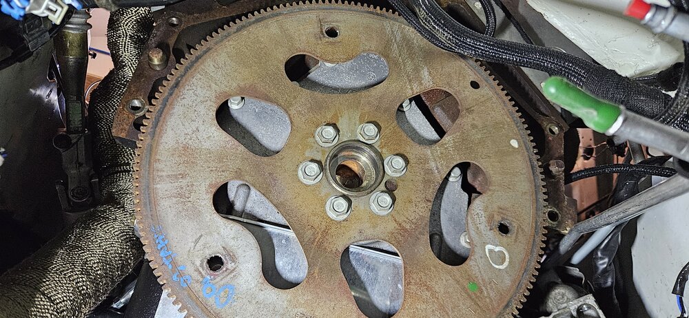

If you would, take a picture of the back of the motor. I'd like to see the flexplate and the crankshaft hub. This way, I can figure out if there's any issue with long crank/short crank alignment. If we eliminate that, then we can diagnose further.
Unless you or the previous owner know what the motor and transmission came out of originally and if they were a mated pair.
The crank pilot bore is clean with zero damage. I can see a line where the tc sits, maybe 3/16" in. No rubbing shows.
No rubbing by bolt heads either. There is no sign of that, plus, there's a ton of room for bolt heads with this flex plate.

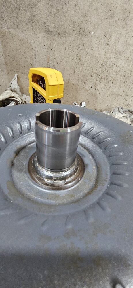

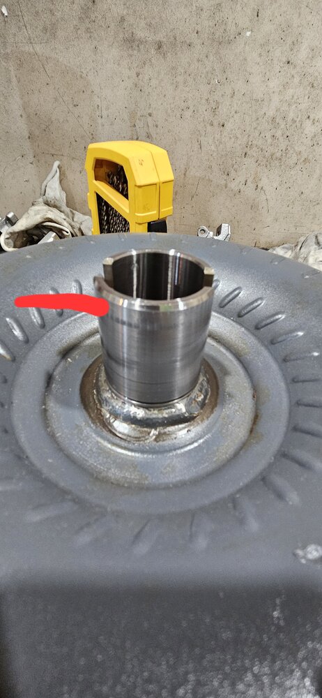

The converter fits well in the back of the crank. It slips in a good bit, hard to know how far, but enough. Crank bore looks great. It still did have a small burr on one side.
The od on the converter has a weird swirl that's not even. The chatter that shows is a reflection in the video.
A transmission guy i know said to make an adapter to spin the converter. I looped the cooler lines already and will make something tomorrow at work for that. We'll see if that makes any noise.
Those chatter marks would be right about where the pump rotor sits around the converter stub. The black looking rub mark would likely be the front pump seal.

Well shit. I mentioned running it longer since I only ran it a min the first time. I pulled the flex plate and I don't see anything external. It looks like it had never been removed.
Aaaand, the starter isn't touching.
