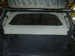

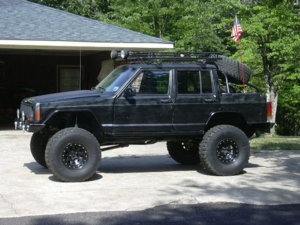

Here is a pic of the wifes rig. '99 XJ full interior cage, back cut.
I used a duster on the back to keep most of the elements out and can still use the AC.

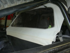

Here are a couple more pics
I like the looks of that "cut back" more and more every time i see one. Who knows, maybe I will thrash mine and go that rout. i should probably sell the good rear hatch first, then thrash it!
Thanks for the pics, looks cool!
I notice the jacked up hood mod, does that help much with cooling? Greg told me about that mod, but I have not done it yet.
