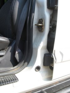

the striker is about 1" lower on the newer XJ's, there woud be work required to make the swap. I think I remember seeing this done on a build thread here, the MJ Commanche with the new gen front clip, was that woodkrawler?
lemme snap some pics...

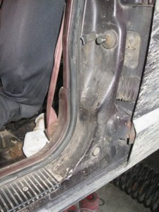

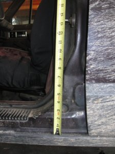

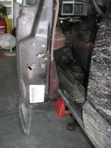

91 XJ...

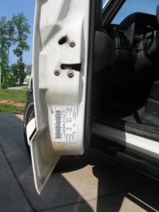

Both striker and latch look different. The old striker uses one hole in the B-pillar, I bet the top hole in the newer style is the same location. The latches also look different, notice the different hole pattern in the door shell, and of course the slot heights to match up with the striker.
yeah, judging from your picture, the top hole of the new style looks like its the same height as the single hole of the old style.
