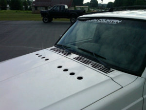

I was going to cut parallel slots in my hood about 1/2" apart, like 8" long and twist the metal to make a louver integrated into the hood.. Cheap.. Mine hasn't been running hot, just like 215 or so (even pulling a trailer).. Forcing the fan on seems to help it out..
buddy has a 94 XJ. it had some goofy carbon fiber hood scoop thing on it for looks when he got it, but since it started getting hot we cut out a hole in the hood to the shape of the scoop (opening facing winshield) and wired up dual electric fans, and it runs steady 210-215 on the trail and 150 on the street. it only gets hot when he gets hung up on something and spinning a lot without moving. now that we painted the whole jeep the hood scoop really done look bad, and you can feel the heat coming out of it when you put your hand behind it. scoop was like $30.

This is how mine turned out with 1 3/4's...

just like xjsavages hood i did mine a few weeks ago at ure at camp took 10 mintues tops.
