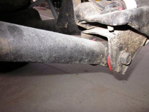

Also plan on trimming the top of the mount that the lower control arms mounts to where it meets the axle. I had to cut a half inch off mine because they would hit when suspension was extended under flex, etc. If you don't want to trim fenders the biggest tire you could run would be a 31
Also plan on trimming the top of the mount that the lower control arms mounts to where it meets the axle. I had to cut a half inch off mine because they would hit when suspension was compressed. If you don't want to trim fenders the biggest tire you could run would be a 31
lower control arms would hit when fully extended.. uppers would be compression, no? got a picture? I wouldn't recommend trimming anything off the CA's.. Only trouble I had with mine was the uppers compressing far enough to cut the auto trans lines on a hard landing, and that may have been to bump stops gone bad..

I might have said it backwords. I will try to get you a pic today. George
Pics

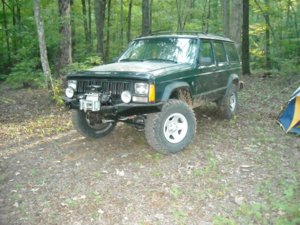

Here you go.....You can see where I cut the bottum of the shock tower. My cut is not perfectly straight. I didn't realize they were making contact until after I installed the lower link bar. It was very hard to install. Rather than taking it back off I just squeezed the grinder in there and cut away what was needed. Also here is a pic of what a 3 inch lift on 31s looks like. I hope this helps...
Pic
3 inch lift and 31s. They still rub when suspension is flexed hard. As you can see 33s will never work.
