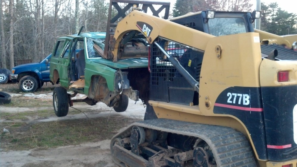

Well that's not quite what I was doing but I guess it would work for that too. I was just moving the old body around.
