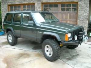

XJ with a 3 inch Skyjacker lift
Mine is a daily driver. So I did not go crazy with a big lift. I installed a 3 inch SkyJacker Lift which was easy! Did not require any major mods. Here is my jeep on 31s. I wanted it to be street friendly but still hold it's own on the trails. Hope this helps!
