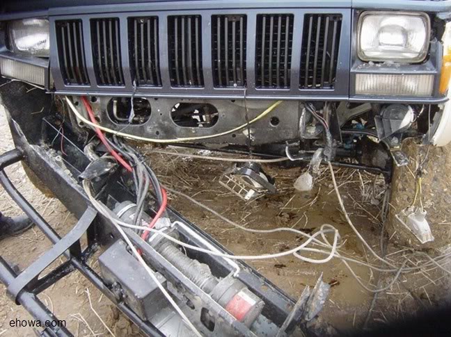

Make sure what ever bumper you get that it has plates done the frame. If it just uses the factory bolts it'l rip out like this.
ai85.photobucket.com_albums_k51_hadfield4wd_Other_20Jeeps_20type_20pics_lostjeepbet14.jpg
yep. anything with a tow hook reciever or has the potential to pull harder than a large dog on a chain should use alot more than the factory mounting point front or rear......
sheet metal doesn't add up to the pull rating of any winch not even a a "harbor full of it 1500lb bugger puller"
My XJ weighs in at around 4500 pounds now. I winch with my bolted on bumper all the time. Mine is fastened with grade 8 hardware and is not reinforced. I consider myself lucky thus far. :) Most of mine are straight pulls, but I've done my fair share of sideways pulls. Despite my luck, it's still a good idea to plate the frame before bolting on your bumper.
my neighbor bought a bumper from the guy in mt. airy and it's pretty nice. the money was right too. it used more than the factory bumper bolts on the front sheet metal. i helped my brother build his xj bumper and he was wanting to build it really thick and reinforced. i told him it doesn't matter how strong the bumper is he's still bolting it to sheet metal.
