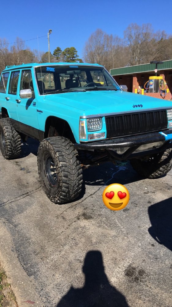

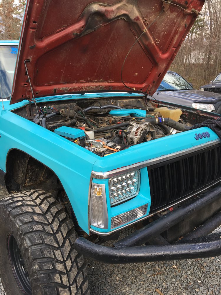

I picked up a 89 XJ a few months back that has a motor swap. The 5.2 V8 came out of a 93 ZJ.
It runs like a top, but when you try to accelerate quickly it sputters. If you roll out of the throttle a little then it takes off like a rocket.
The previous owner, that had the swap done told me that during the swap they left a sensor/ connector or something of the sort out. And that because of this it's sending a default fuel pressure that is higher than what it needs and is flooding the motor.
I'm not 100% sure what to think. I ran some seam foam through the vaccumn line and put a can in the tank as well. My next step is to change the fuel filter and if that doesn't work change the fuel pressure regulator and then fuel pump.
Can anyone offer any insight? I'm use to the I6 4.0. Could really use some ideas.
