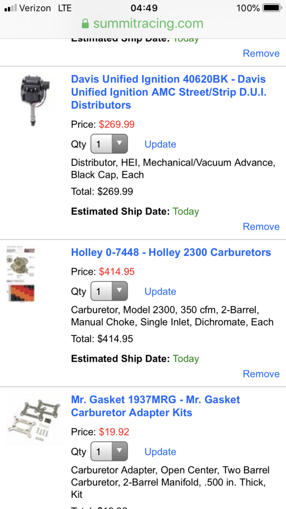

Is this the correct setup?
It’s a summit cart
Tell me if this is the right set up
87 yj
4.2
2hats your budget and what's your intended use
Been around 2 FiTech systems with @Noel and they’re awesome! Stupid easy to install, self learning and reliable.
You change a cam or something later, just let it relearn, you build a stroker later, just let it relearn. For a little bit more you can upgrade to the one with an electronic distributor and get even more advanced.
Of course this is a YJ so not your intended use. But if your Jeep was totaled or a rust bucket one day you can take the FiTech system off and put it in something else. It’s not vehicle specific.
What everyone else said. Spend the extra dollars get self learning efi. It's getting harder to keep carburetors running right with the crappy stuff they pass off as gasoline these days.
I'll buck the trend....not knowing how you intend to use your vehicle efi adds complexity with minimal return for a street cruiser.
My experience with FiTeh was vastly different than what you are hearing in this thread. Now I was trying to use it in a higher flow application than an I6...they may work fine for that. Their tech support was less than useless. It was a bad experience. In the end I gave the (2nd) unit they sent me for replacement to a friend for free. I couldnt take money from anyone for the junk I was giving.

I didn't want to be the guy...but that's been my experience with FiTech as well. We sell about 2 dozen efi kits/month. FiTech is by far cheaper, but there's usually a reason for that. Install is easy, but tuning/self-learning has been shit. Majority of our customers have either gone back carb or Holley Sniper like we recommend in the first place. In my groups, I'd say there's only about a 50% satisfaction rate with FiTech as well. And I'll echo the useless tech support from FiTech too.
@SDIVER2006 as to your shopping cart that is what I ran on my ‘85 CJ-7. Took a bit to get it right but once it was tuned it it was smooth easy to start no issues. I did spend the money and had an electric choke though. Only thing was I had to change the advance springs in the dizzy to get the advance right but DUI was easy to work with and they helped out really well.

1) To answer your original question, I ran that same set up on my 89 YJ and it worked great. I did the nutter bypass on the wiring, set of headers and with the carb set up the jeep ran better than ever.
2) If this is just a weekend driver, I would do what @Ron suggest and go with the Rock Auto parts and enjoy good results.
3) You are getting close to the FI range in cost with you parts. I have had great success with the Howell TBI set ups and would be hard to go back to a carb on anything. if this is a daily driver, I would save up some mo money and go fuel injection knowing what I know now.
