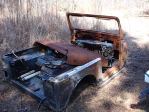

I'm sure some of you saw the burned up yj for sale here a while back. well...i'm either crazy or stupid, but that is now my next project. the tub is in good shape just has surface rust all over it from the fire burning off the paint. the frame looks great and the axles i got for it aren't too bad either.
My plans as of now are to run the bronco 44 and 9" axles with a soa with reversed xj leaves. I'll be running some coils up front with extended radius arms. after sandblasting the tub i plan to dovetail the rear and make flat fenders up front.
this is as far as i've gotten other than collecting parts for the incomplete 44 i got and picking up some suspension parts. I plan to glass bead the tub soon. If anyone has any input let me have it as i go. i'm learning on this one.

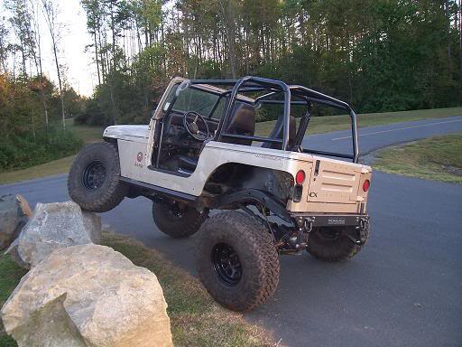

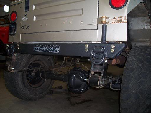

nahhhh! Here is a YJ that we built with XJ rear leafs for a buddy of ours. Bolted the crossmemeber on... Maybe it will give ya a few ideas.
