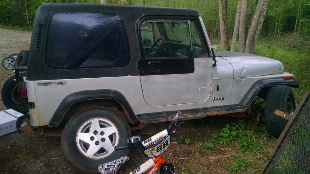

I've got a 87 yj, planning to swap a xj front end under it(among other things), maybe a zj rear (yeah it's a 35 but it's free.. Other option is a xj 35)
I was pondering if the lower control arms might bolt into the rear spring hanger on the front and add UCA hanger and spring mounts.. Yeah, I know I could get a tj for less than the work I'll have in it.. Other thoughts were land Rover radius arms (free as well) or a three link.

So a quadralink suspension or radius arms ride no better than leafs? My wife had a yj before and I thought it rode like crap.. Could be the wheel base difference there too. So yeah, no practical value, but does a resto-mod have practical value other than to improve something you like for yourself? 1461667567426313505390.jpg

So for those interested, stock xj lowers are 16" c-c (give or take), 17.5" from axle tube to bolt at level height. Yj is 20.5" from axle tube to leaf spring bolt at level height. Short of long is that xj lowers will not just bolt in without pulling the axle back about 3" (or moving lower CA mount forward. As well, the spring would have to sit under the frame(yj frame at axle is wider than xj at the axle), with stock xj springs would be 5.5" lift or so (assuming front weight of xj & yj is similar). So I shall answer my own question, No the lowers won't bolt in. Can it be done? Sure, longer links than the xj. It'll be a few weeks before I post up my links (paying work interferes with my desires to fab). That or I could move the mount forward but I'd rather lengthen the arms that few inches, and no I'm not welding two stockers together, although it may end up bushing instead of JJ or heims since it will be parts runner/street/trail ride.
