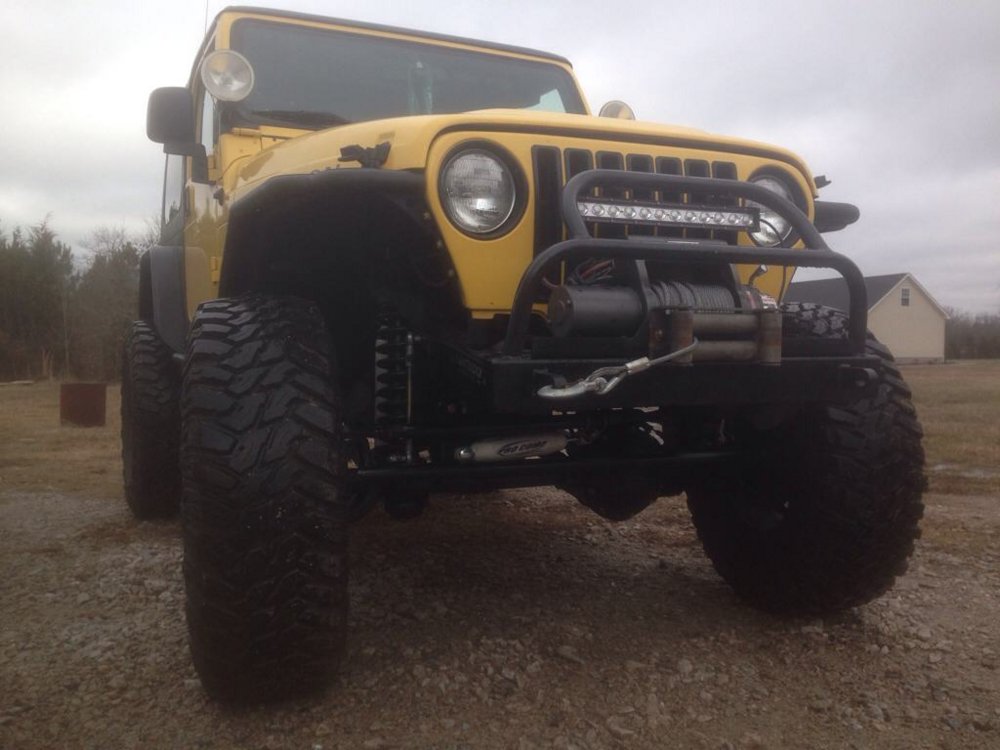

You could do the wj steering swap I just got done with mine turned out good
WJ swap would be a good upgrade for the 30. I think you just put WJ knuckles and brakes and all on your axle. Which is a good brake upgrade too.
I just put a 1 ton cross over kit from ECGS on my TJ. I'm running a full width D44 on mine. But it could be cut to length on yours too. You just have to get your passenger side knuckle machined to except a hi steer arm, as well as both knuckles and pitman arm reamed to except the 1 ton tie rod ends. It's not that much at a good machine shop. ECGS can do it too if you send/take it to them.
With that said I will also add that ECGS are GREAT people to deal with! Excellent customer service, and the kit was at the shop the next day. And it is huge and beefy. I actually slammed it on a few rocks yesterday and it was supporting the full weight of my jeep. I can post a pic in a little bit of my steering of you'd like.
For tho wj swap u would need a set of wj knuckles wj lower ball joint a set of 02 sport trac rotors and a one ton steering set up I got mine from ruffstuff but ecgs would work
