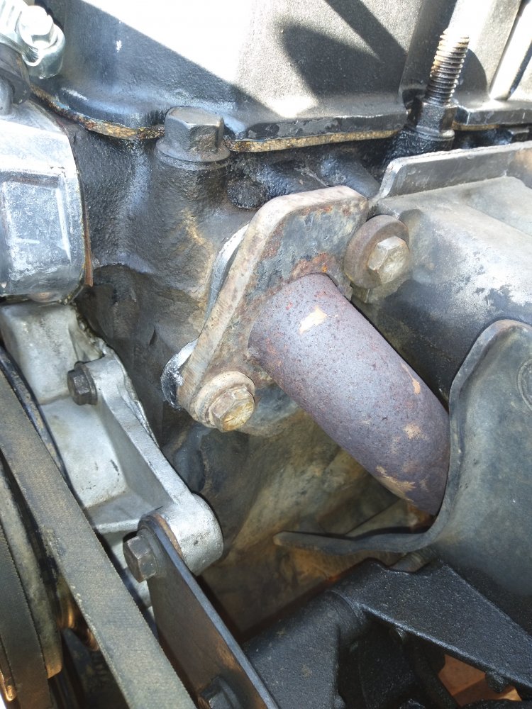

I have a 87 YJ with a straight six. Bought oil filter for it and it does not fit. I think it should be M20x1.5. Turned out to be 11/16" I believe. Block stamp reads 307C21
Any idea what engine it is/ year...

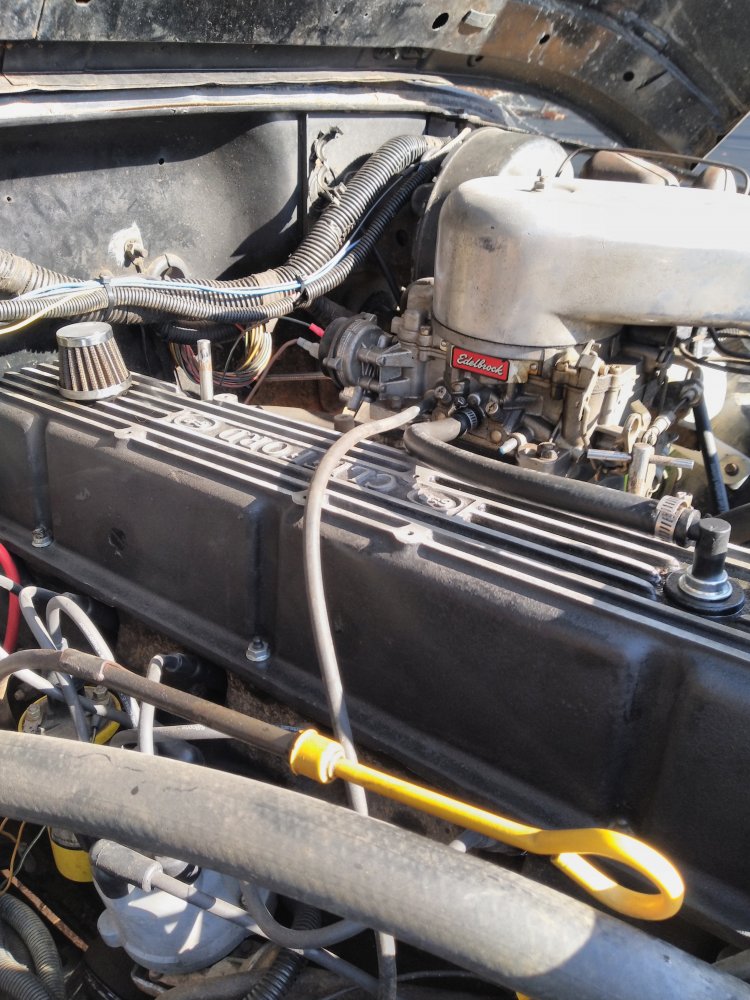

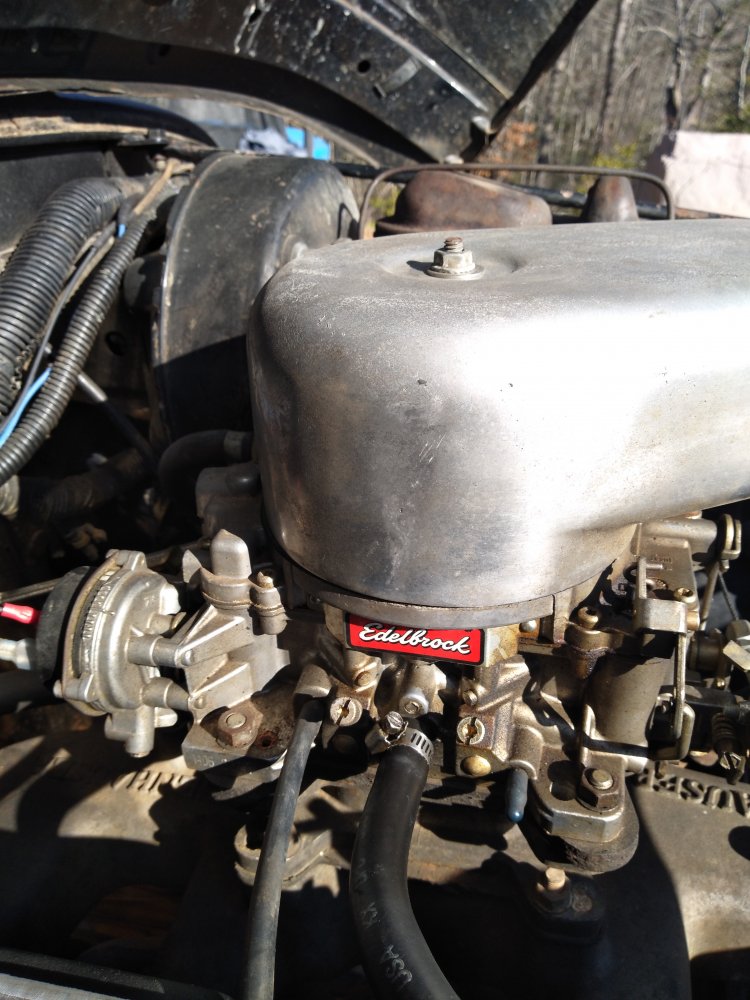

Someone installed a Edelbrock 1406 4 barrel with offenhauser intake and a header

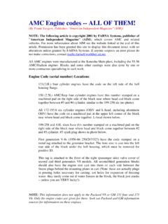

Thanks for the link, Turns out my engine is definitely a 61,70,79,83 or 93
It also says I need to find some other numbers that are cast into block to figure out which of the above years it is. It's almost like a treasure hunt:bounce2:
