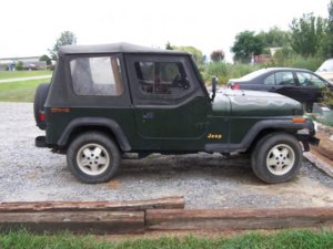

I'm trying to get some ideas for my YJ and was wondering if any of you guys that have a yj with lifts, v8s, full widths would let me take a look at your rig. Pics would be nice or in person so i could get a good look at what is done to your rig would be wonderful. I do not have any friends that have mods on 4x4s so i dont really know were to start. Any help will be Appreciated.MY yj has a 2.5l and 5 spd so I will prob swap the 2.5 for a v8.

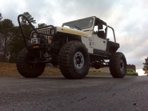

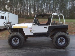

I was just going to collect parts until i got everything that i need as for budget im just going to buy parts when i get the money.As for where i wheel and what i do, I have aways had mostly stock toyotas with blocks and mud tires i would like to keep the tag on it for transport but i will trailer it any thing more than 20 or so miles and that means any were i go wheel. the red and white yjs thats what im trying for
