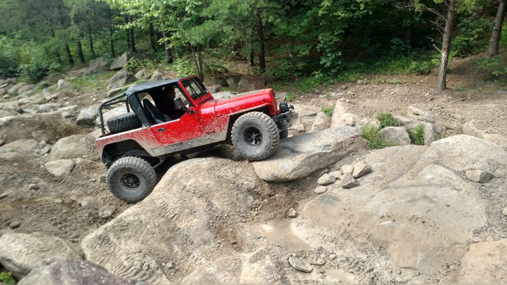

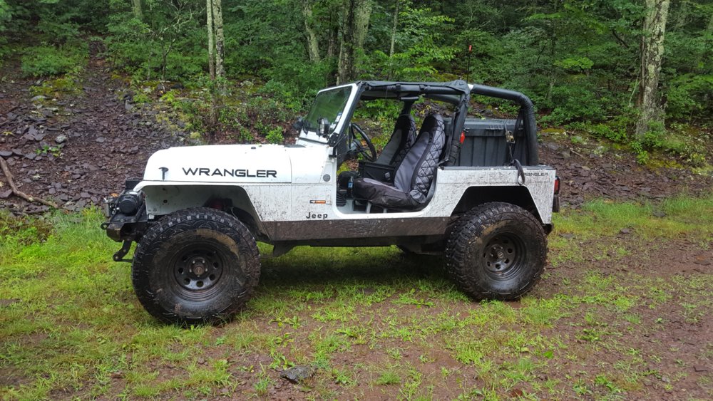

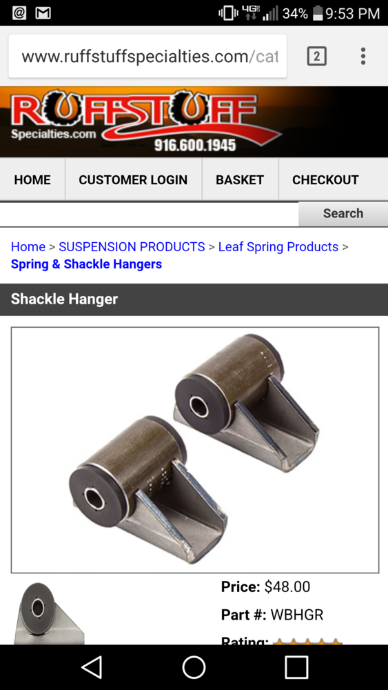

I used a Barnes 4wd tail plate and welded shackle bushings to it, using the D ring tabs as a gusset. Then moved the spring hangers back 6.5" on the frame and reused my YJ leaves. Staying SUA with military wrap leaves cuts down on the spring wrap. Lost all my pictures from when I streched it, can get new pictures if you'd like.
YJ Rear Tail Plate Bumper
DOM Sleeve & Poly Bushing
Heavy Duty Leaf Spring Hanger Pair
This is on 35s. Most people don't notice it's been stretched because of the corner armor.

RCI full cell in the cab. Front is in the stock location still. Shackles don't hang up any more than at stock wheelbase.
This stretch was done with the 3" lift YJ springs that were already on the Jeep. If you're happy with the springs you have now you can keep them and just move all of the mounts back the way I did. It gives about the same amount of stretch as the reversed XJ springs. Like @paradisePWoffrd said, you'll get a ton of axle wrap running XJ springs SOA. YJ springs SUA have much less axle wrap, but they don't give as much flex.

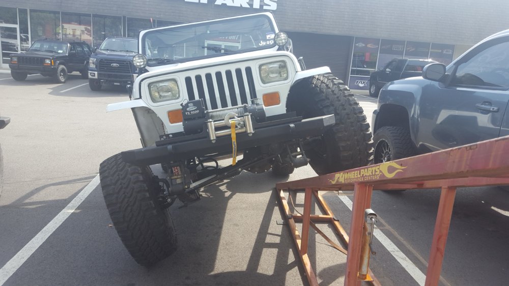

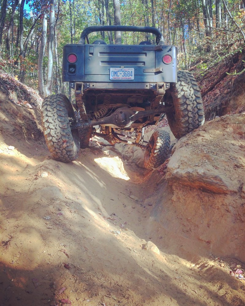

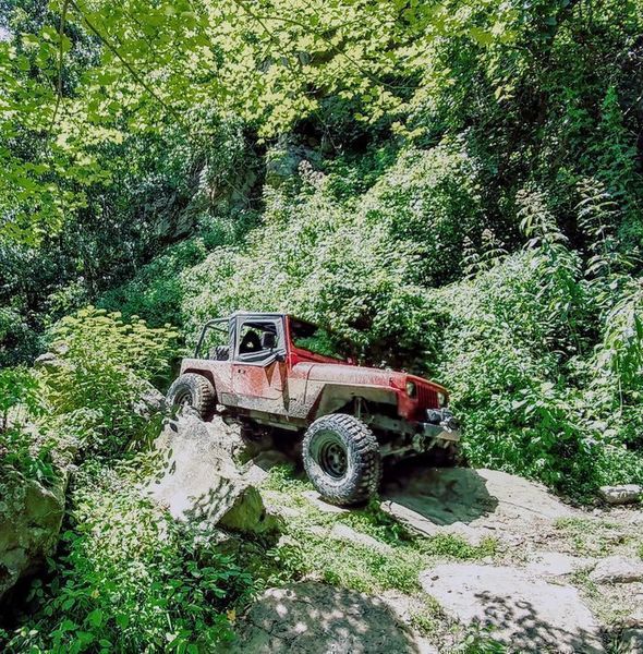

I have stock waggy springs SUA on my YJ with 1" shackle lift and 1" body. The waggy springs do take some searching to find, but with some patience its not too bad. They ride really well compared to my old rough country and make the jeep feel much more stable on obstacles.
You will have issues with high steer though, unless you push out the steering box. As far as the gas tank, all you need to do is the dimple mod and be done.
Pics below for reference (35" tires).
