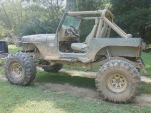

XJ springs front and rear, shackle frame mounts are from Barnes 4WD. Front frame extended but adding a piece of 2"x4" tube to the frame rails. Rear is C channel slide over the frame rails with factory rear cross member removed. Running a astro van steering box in the front. Any other questions feel free to ask. As other have said, run a anti wrap bar. I'm not but need to add one.
