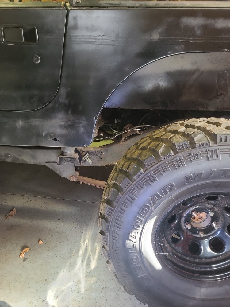

Wagoneer springs. 1 inch stretch perches. 35 inch tires. Total stretch 3 inches. I know it has a body lift but you can see the stock fender opening will clear a 35.

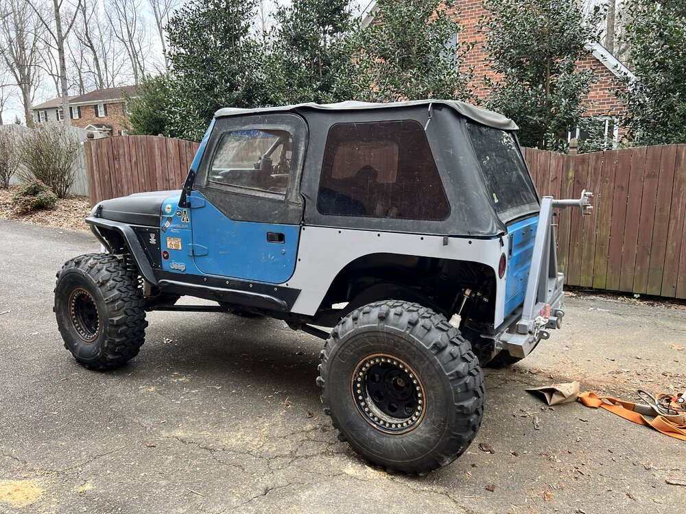

This rig is my son's daily driver and he runs 35" falken MT's daily but we swap in the 42" TSL's for the trails. No sway bars, psc assist, and it works well. I frequently commute to work with it at a 150 mile round trip, then switch to the swampers load it on the trailer and go drive over stuff in the woods.
Only advise: go big, cut the sheet metal, don't look back, and have fun. If you ever wanted to go back to stock you can buy front fenders cheap and the rear of the tub is flat so it's super easy to weld it back in. I kept all the body pieces for mine thinking I was nuts cutting up a solid CJ7 tub, but I don't regret it. It's a much better driver in all circumstances now than it was when it was stock.
