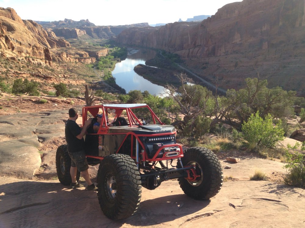

87 22rte engine. Blew another intake gasket, repaired it and now it's sputtering BAD. Ran fine before the fix. Replaced fuel pump, both filters, checked all kinds of things. Been out here for 3.5 days and haven't wheeled more than 3miles or so:kaioken:
Checked all lines. Sprayed the engine down with 2 cans of starter fluid, never hit a lick
