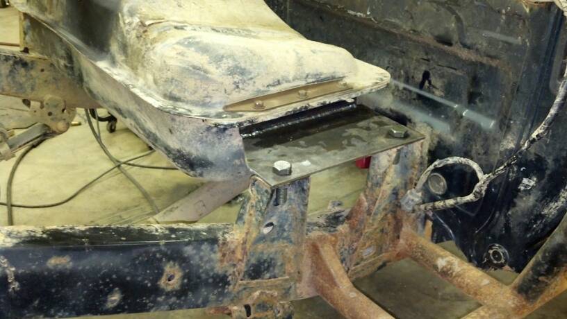

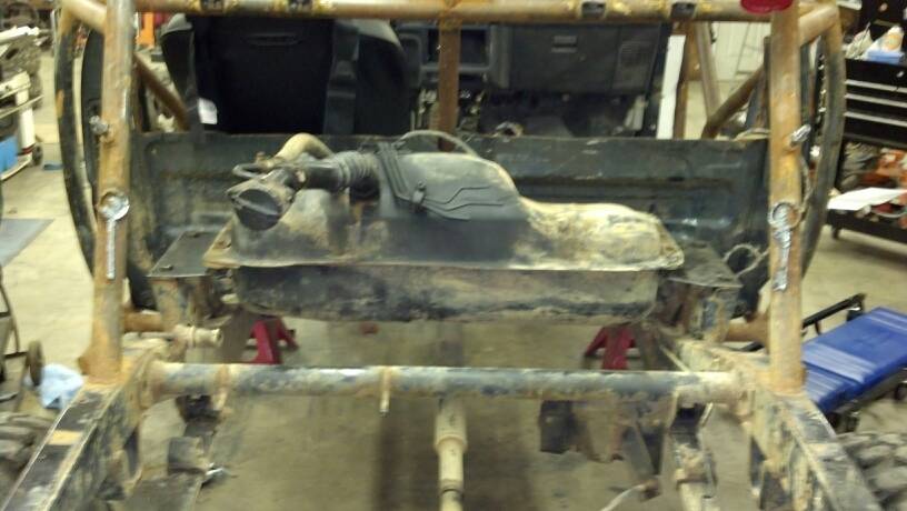

Mine has the stock tank turned sideways because I'm a cheap ass and it was easy. Gauge still works, all the wiring worked, just had to extend the fuel lines a little. I vote for the stock tank cause it's easy.
On another note, with the tank sideways, be sure you have more than a half tank when wheeling. I once ran out of gas with a half tank on a-piller at the shop. It's kinda embarrassing to have to winch your truck flat to get the motor started....
Post up a picno
Post up a pic or two. Short bed tank?

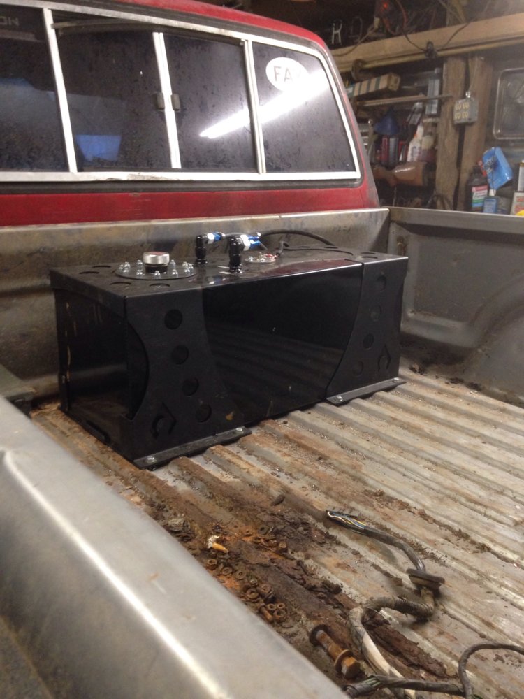

I mounted the RCI 19 gallon in the bed with Artec bracket system I haven't hooked the sending unit up yet, running an external pump. I haven't run it off road much so I don't know how well the pickup works off camber.
I mounted the RCI 19 gallon in the bed with Artec bracket system I haven't hooked the sending unit up yet, running an external pump. I haven't run it off road much so I don't know how well the pickup works off camber. View attachment 290876
Very similar to how I ran the cell in my XCab when it had the stock carb and it idled on the waterfall at Mtn City. No issues. Same thing when I put a cell in the 4Runner with a 22RE. Both ran on just about any dumb angle my drive by braille skills got me into.
