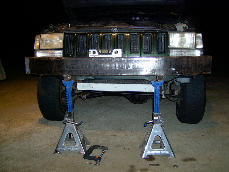

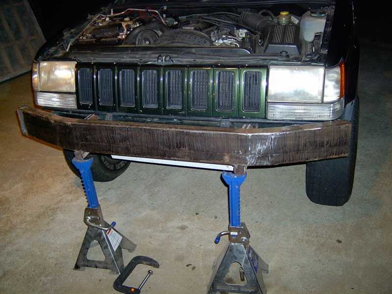

have been building this front bumper for my ZJ and was now to the point were id like sum input on things i should do or change on it. wanting to install an winch n the center thats y i made it stick out like that, then cut sum of the metal cross piece behind the stock bumper right n front of the rad. to get the winch a lil more room and have it back lil from the front of the bumpers face.
things i still have to do,
1- weld n the plate for the winch to be mounted on.
2- either cut bumper at an angle on the ends for more clearance or just leave it like it is.
3- complete mounts for the bumper to held on to the unibody
4- also was goin to make plates that went from the front of the jeep to the bumper to inclose the bumper more, but leave the area were the winch well be opened up.
If ne of the things i wrote make since, please help me out. thanks
looks like your on the right track cutting the front sheet metal is a good idea it can gain u 3" for winch. make a skid in center to go under rad. support,angle cut ends for tire clearance .try to keep the weight down zjs are nose heavy as is.
