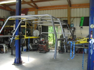

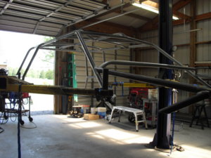

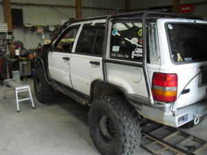

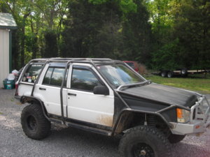

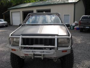

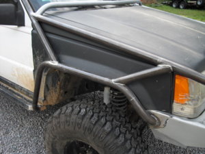

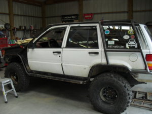

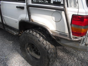

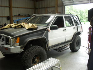

We started an exo cage for a fellow NC member here at the shop. Here are some pics. It is all 13/4 .120 wall DOM. Thanks PJ
tube
There will be about 6.5 sticks in it when its done.

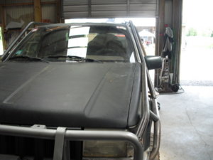

Nice work PJ. Looks like those bumpers served as a good platform to work off of.
As far as weight, I calculated it should add a little over 270 lbs. That is based on 20 feet in a stick times 6.5 sticks with each foot weighing 2.089 lbs.
Yes, that is some weight but I don't think it is too bad especially considering I am well over 300lbs haha :D Plus the added protection for me is priceless.
