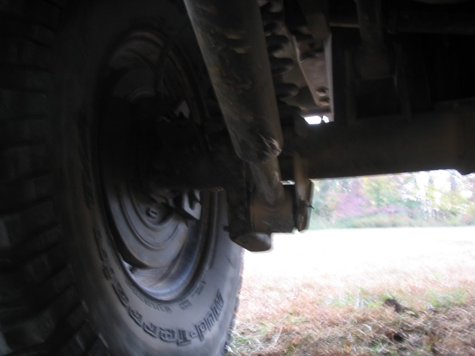

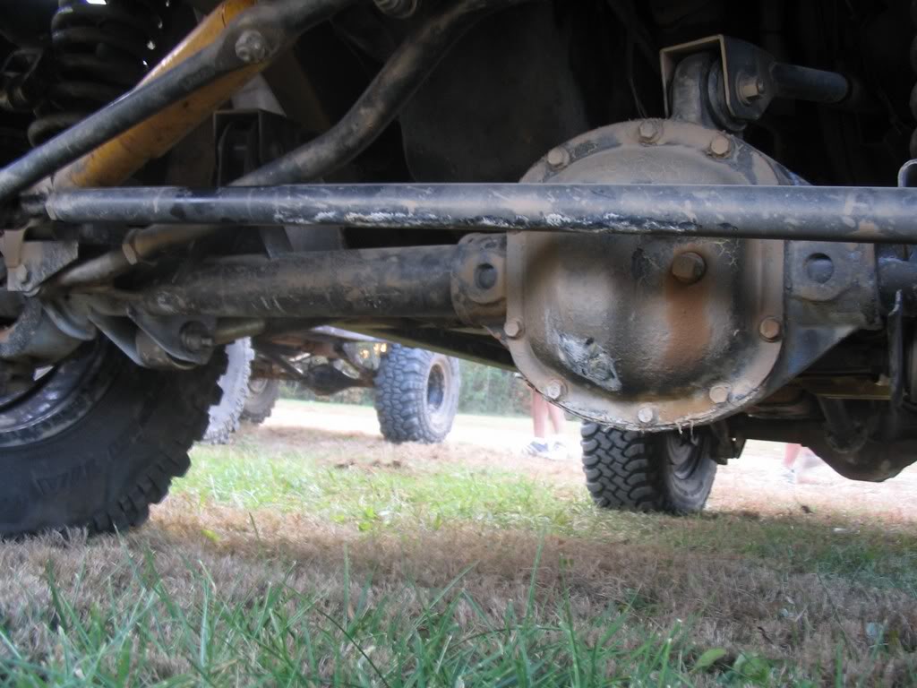

and loses. :flipoff2: well actually I pretty much walked up everything, we ran several trails but stopped after that farthest right line on rocky mount loop claimed my tie rod. As a quick fix we pulled it forward with a winch (just to keep it off the diff) and bottle jacked it up until it was straight enough to drive home. After a little alignment I didn't even get death wobble. All in all it was a great day to test everything out for next weeks trip to tellico. I just hope my currie steering doesnt pretzel up like this whenever it gets here. Onto the pics.

yeah tell me about it. I'm upgrading it with the setup from currie that still utilizes that inverted Y mess but I figure on the trail it'll be easier to swap out a broken TRE than a knuckle. I'll save dropping money into an axle when it isn't a Dana turdy.

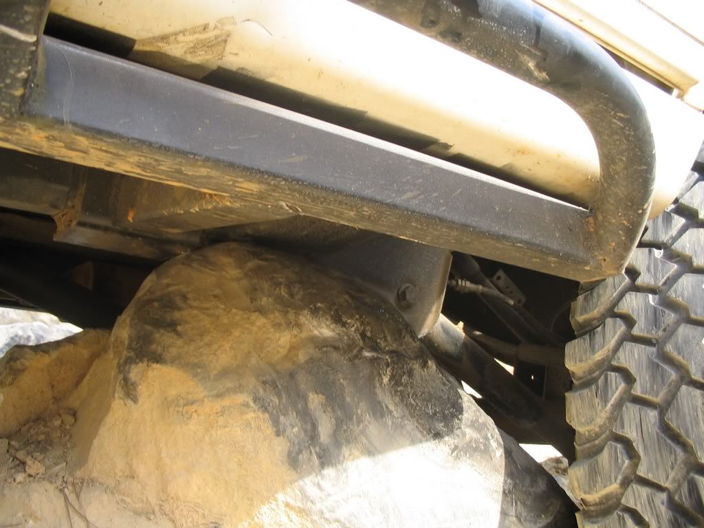

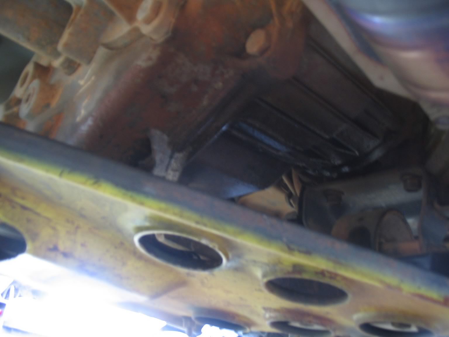

just thought I'd update this same page. Here are pics from today. Just got back and wow it was one hell of a day. The group we went out with day did not fair so well. All in all ended up with 2 busted shafts, 1 destroyed driveshaft, body damage left and right, and my busted tcase. After high centering my unibody on a rock i was able to maneuver around it but not before teetering back and forth on my transfer case. Needless to say it bent my skid plate and crossmember and seperated the two halves of the transfer case. Onto the pics.
