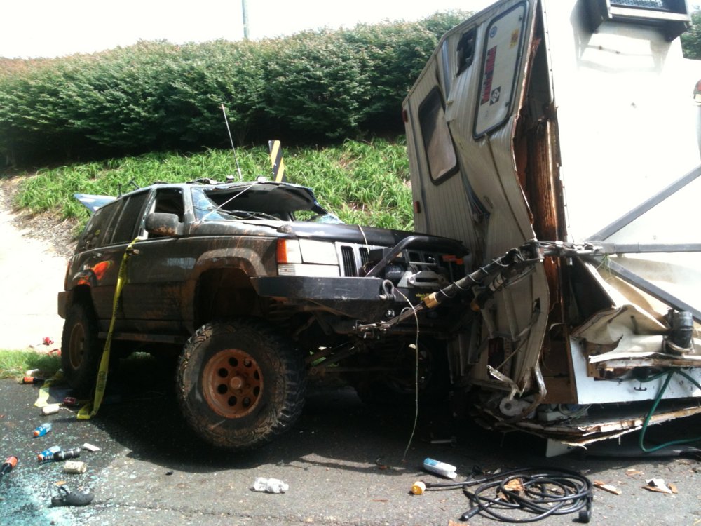

Hi-jack... did I miss what happened in the picture?
It almost looks like the jeep was being flat towed behind a camper when the whole thing decided to roll over and take a nap. myself, I dont see enough damage to the jeep to junk it out.
the whole jeep got warped up. It cork screwed behind the truck before he laid the truck on it's side. Where da hell ya'll been at? This happened last labor day weekend coming back to Raliegh from UNF.
That could have had a much worse ending. Glad everyone was ok.
Thanks, still trying to recover from it. I had just put the motor in that Jeep 3 months earlier so I'm having a hard time letting go of a good motor and transmission. At this point everything else left is scrap.
