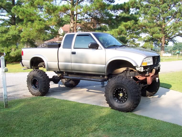

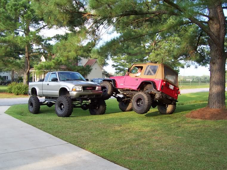

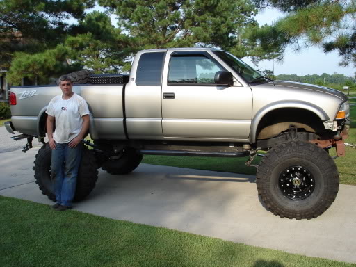

So here is my truck I was trying to hold off until it was done but I am just getting too excited. The whole build can be viewed at www.zr2usa.com or http://s74.photobucket.com/albums/i266/gogogadgetbiker/
Here is the list
-1979 HP D60 5:13 yukon gears, ARB, Chromoly outers, 3/4 ton chevy brakes 1410 yoke 100% new except for housing.
-NEW 14 bolt rear 5:13 gears, Detroit, 3/4 ton chevy brakes, 1410 yoke.
-Hybrid transfer case part 2002 GMC 233C, part 1990 Chevy 231, part 1996 Chevy 233C "wide chain stuff" and JB conversions SYE.
-38.5x14.5x15 TSL SX's Qty 5.
-15x10 Eaton Simulocks Qty 5.
-High Angle rear driveshaft 1350 CV 1410 @ axle.
-Offroad Design High Steer and Crossover steering.
-Viair 450C compressor and tank.
-Alcan +4" rear springs with torque leaf.
-Alcan +4" wagoneer front springs.
-Classic tube brake lines.
-PSC reworked steering box reworked to throw to the front and ported for Hydro Assist.
And here are a few pics, there are more in my photobucket posted above.

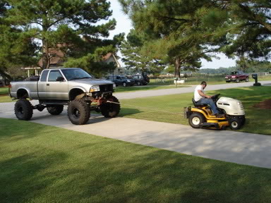

Built might be built, but if ya' gotta have a lawnmower to get it up the driveway...J/k. Looks good.

Looks good bro! Did you move the front axle forward some?

love the truck, but i gotta ask, whats up with the cub cadet tow rig?
Yeah, could drop the body lift and still have plenty of room for those tires, and a lower COG.
For now this truck will see just as much street driving as trail driving so I am trying to keep the tires out of the fenders with minimul trimming. Let it get a few dings and I may go to a 40 something tire. But for now it needs to stay how it is.

The truck looks good........almost too good.....aren't you scared to beat up the body? It appears to be in great shape...........................:huggy:
I will try my damnest to keep the body in one piece since as you pointed out it is in very good shape. The whole truck has only got 34,000 miles on it...Nothing like taking a torch to a truck you just bought!! I think in some wierd little twisted way I am just looking for a reason to cut the fenders for more rubber!! :D
