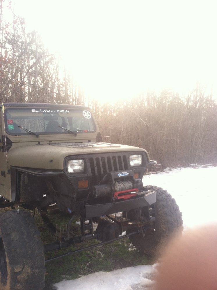

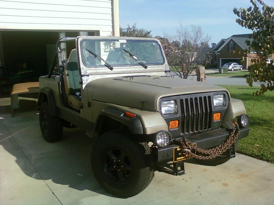

Well seeing all the cool projects on here made me want to start a thread of my own. Now I know I should have started this about 4 years ago when I got the Jeep but HEY never to late to start. Now me and my dummy self only saved the pictures on 1 phone and guess what happend.....the phone decided to die...so no pictures of the original. However ill post one of what it looked like.....NOW!
Only difference is mine has the sport roll bar but the rest was stock. Unfortunately my jeep desided to loose some pounds by rusting :driver:but with some bondo, some sanding and Raptorliner (a tinted bedliner) it turned into this

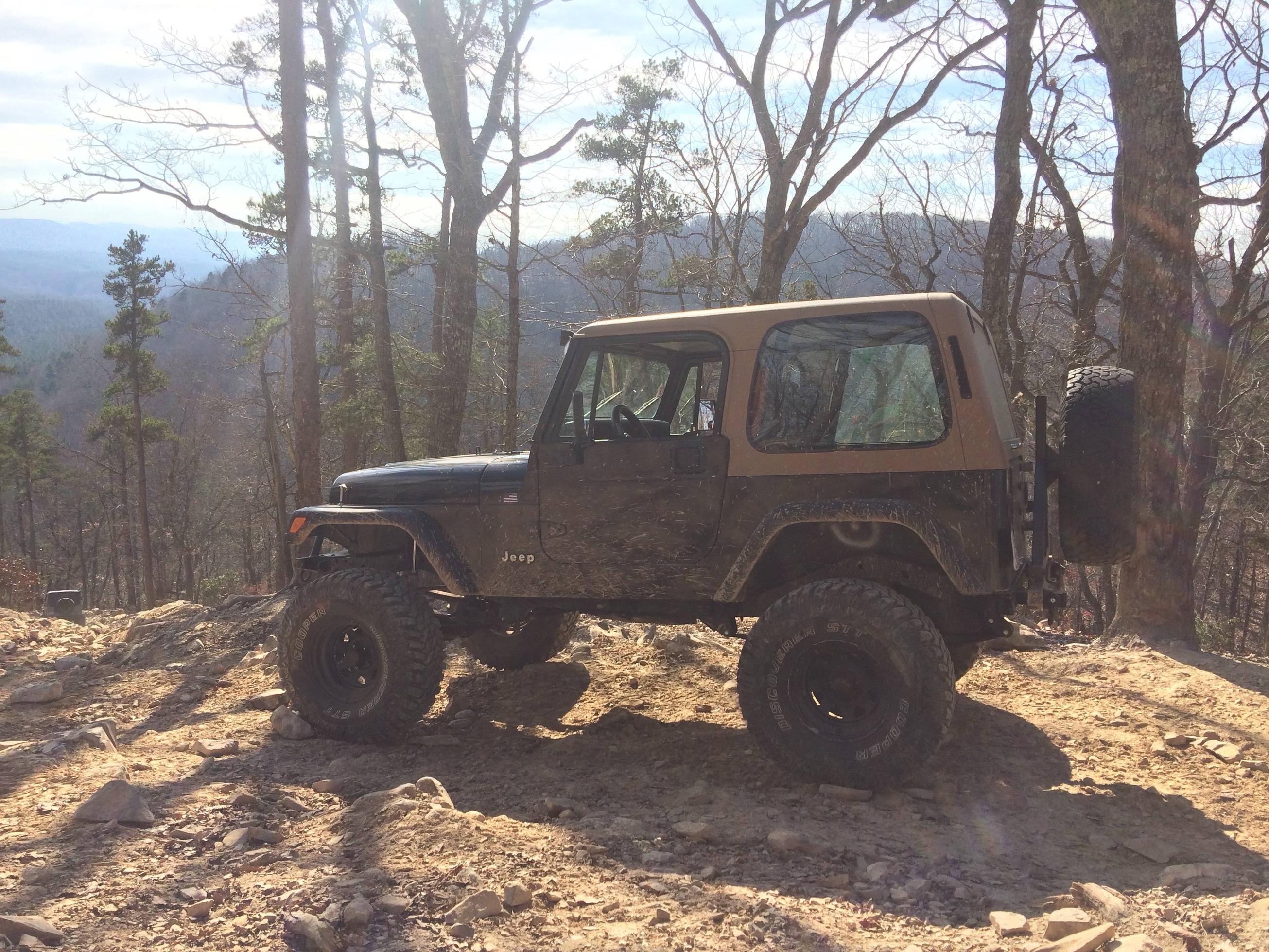

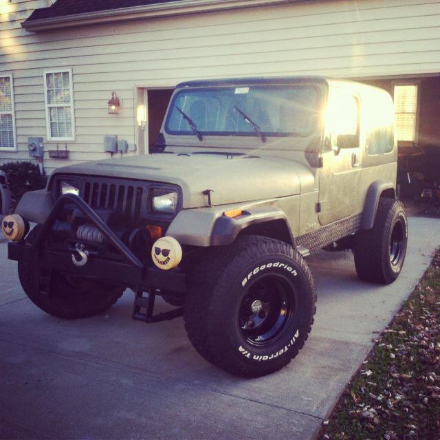

Changed out the flares and put in some TJ seats, little add-a-leaf lift I was ready to roll! :rockon: as with any jeeper this didnt last long and i found a great deal on 33s and turned the jeep into this!

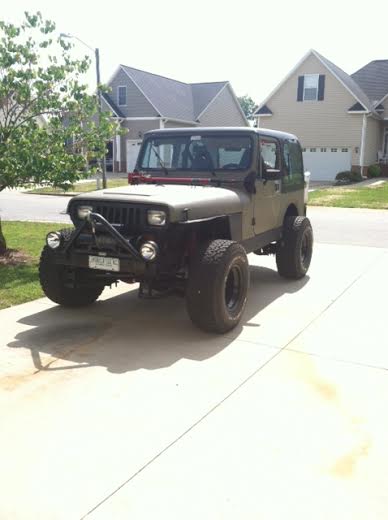

Now this update was when i put on the 33s, i added a winch, stinger attachment and finally got a black top and hard doors. Ran this setup until i finally got tired of rubbing and trimmed the flares

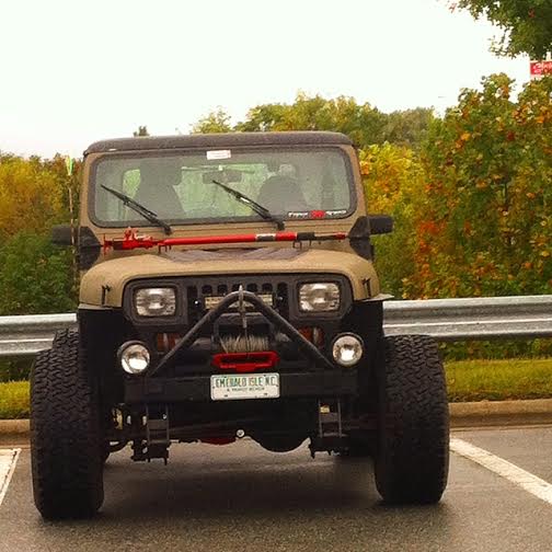

Needless to say i thought i was hot stuff! threw me a hi-lift jack and trucked on!

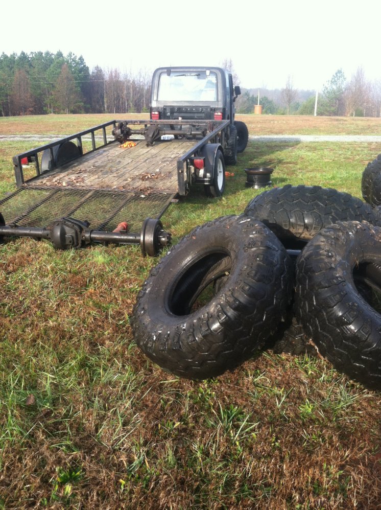

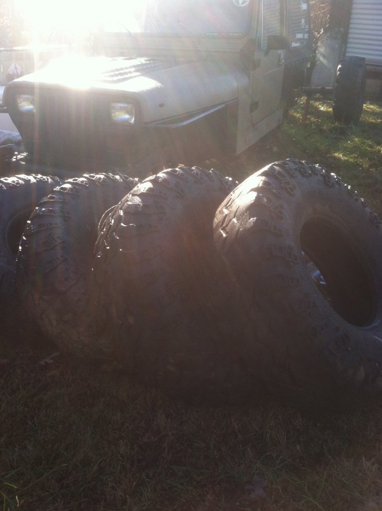

Finally saved up the money (and or cought a time where things wernt breaking around the house) and went and bought some axles. 78 f250 d60 rear with a hp44 front. Perches already set up for soa and ready to bolt on. Now the deal also came with some 37in iroks witch I'm going to run until I save enough to switch them out. Here's some new pictures

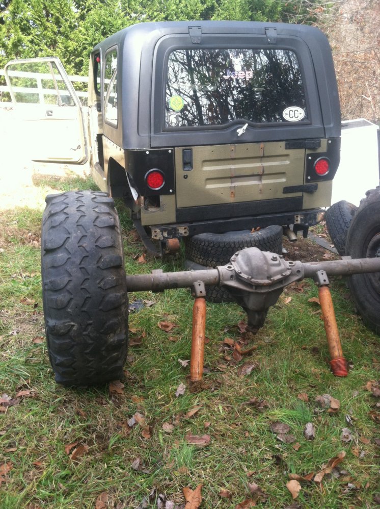

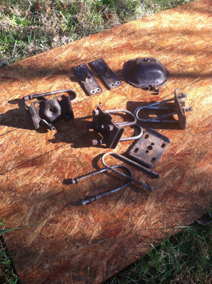

So today was a very productive day. Didn't have college classes so I decided to dedicate the day to the jeep! Thanks to @spraypaintman he hooked me up with what I needed to get these things under... U bolts plates, a d44 cover and even some dring hangers. And of course @retroedaddy for hanging on to the axles and tires for me until I had the money

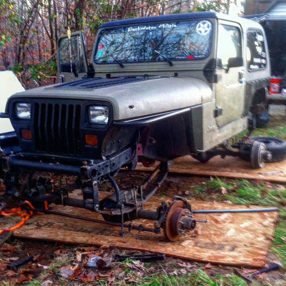

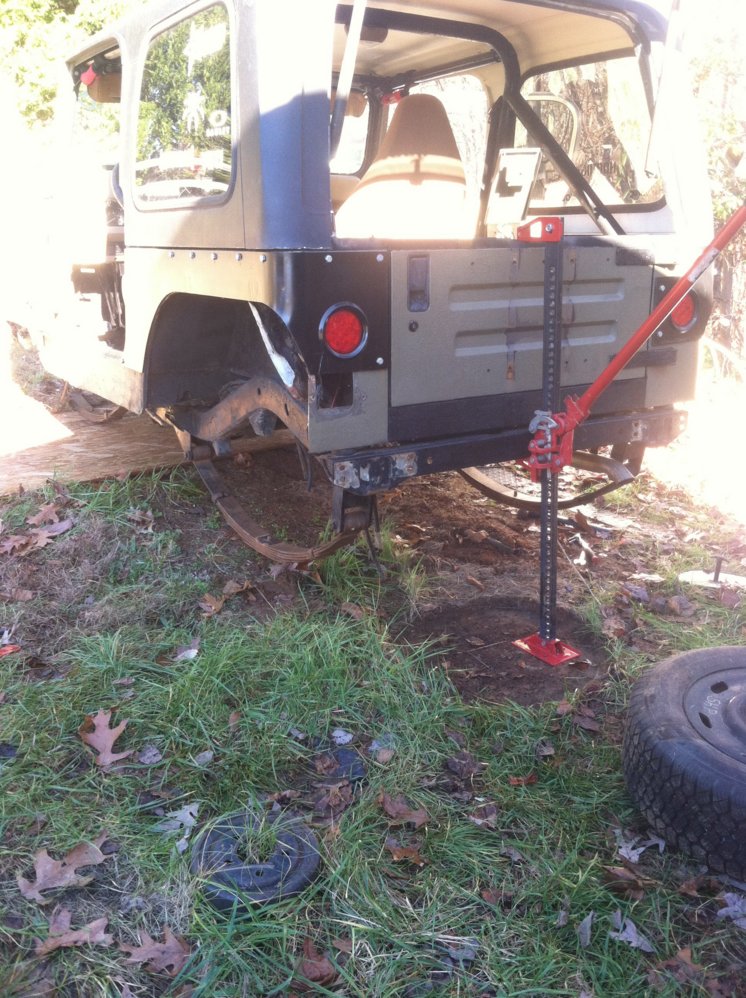

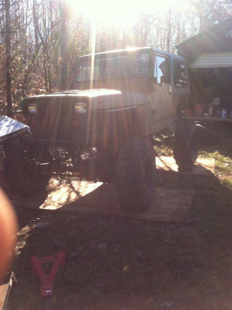

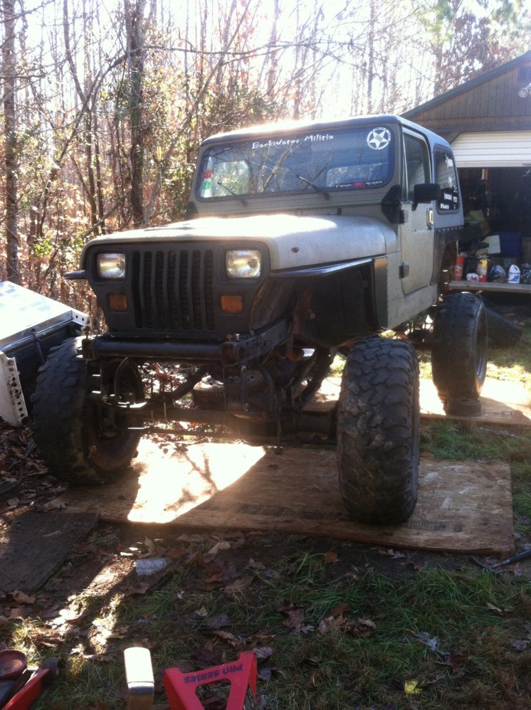

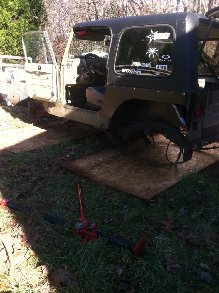

So now came the fun. The heep I call my jeep has been sitting for close to a year so today was great to see it start to come together. Lifting it was.....interesting to say the least. Every time I would put it on the jack it would start to slide. It fell off the jack/ jack stands about 3 times (that's why I had tires under the frame to keep from damaging anything had the bright idea to lay old ply board laying around the shop under and I managed to lift it enough to put the springs under! Then lowerd it and was able to get not to slide got the rear axle under no problems then came the front..... The front.... Very heavy with one person. But managed to do it.. Got everything bolted up and ran out of daylight.

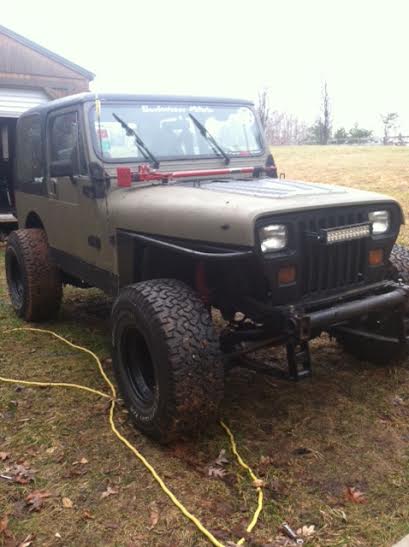

Ahh okay, that makes sense I was thinking it looked much higher than I'd expect. My YJ is on Waggy springs with 1" boomerang shackles and 35s and sits much lower than yours.

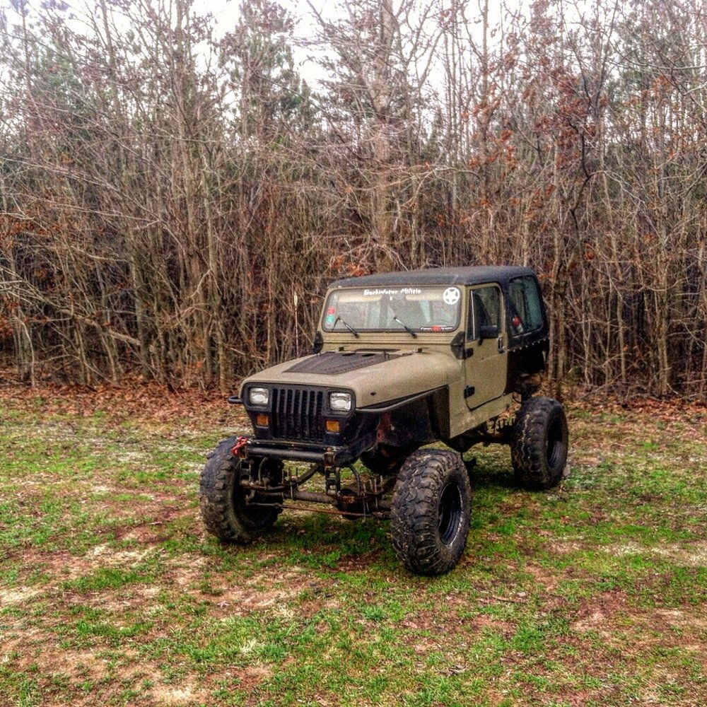

Here's a pic of it.

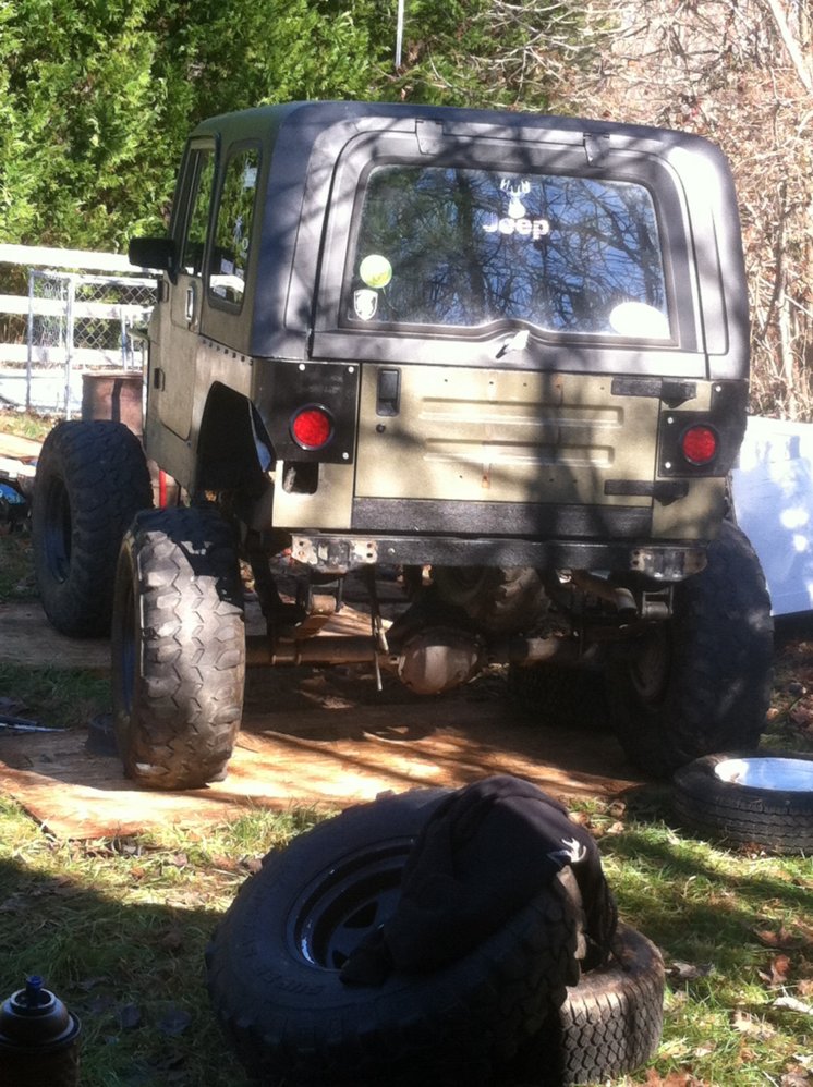

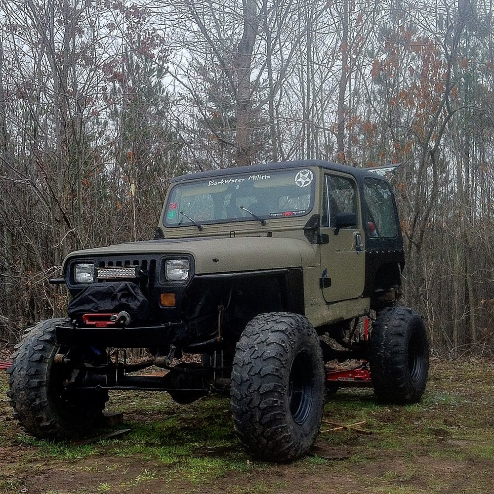

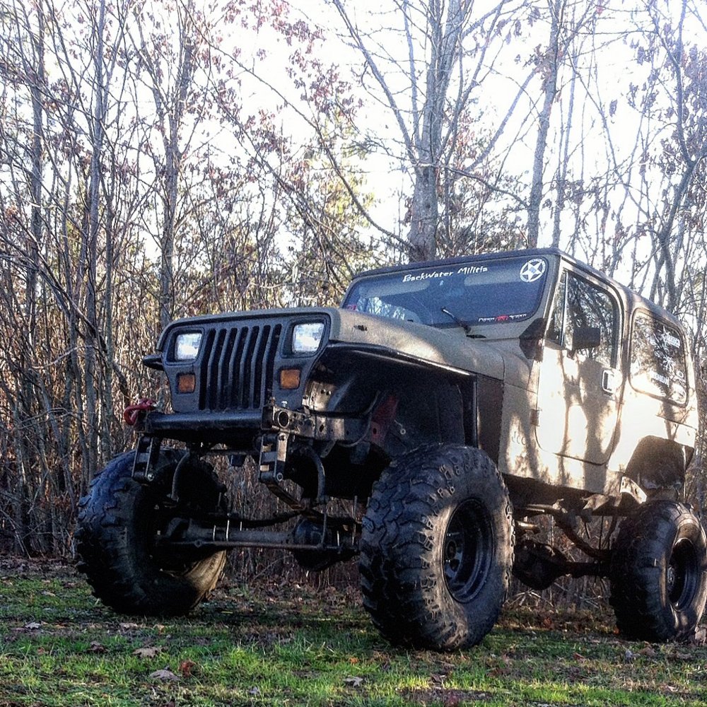

Got the front bumper painted, winch is bolted on and all is well.....very overall pleased with the @Barnes 4wd front bumper! currently messing around with spring packs and such I DID buy some stock size shackles! NO MORE DEATH SHACKLE. still trying to figure out how to stretch the front i like the way the 6in front stretch looks but dont think I need that as of right now. going to get rid of the 37in irocks and go for 40s when money allows. So far so good just slowly building!
Okay so thanks to @Josh C who met me in raleigh for me to buy some waggy springs, got those installed this morning along with a stock sized pair of shackles ride height is near perfect for what i was going for!
