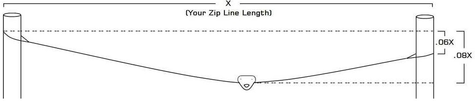

I've been looking at kits. Most of them seem to state for ages 8 and up. I might be jumping the gun on this since my boy won't be 4 until mid-Nov. I've got a good spot on the front of my lot that appears to have a good shallow slope so they will never be very high off the ground and shouldn't pick up too much speed. I'm definitely going to buy one of the kits with a seat. The starting and ending height of the cable along with the proper sag is what I am I most interested in. I found this picture on the internet:
