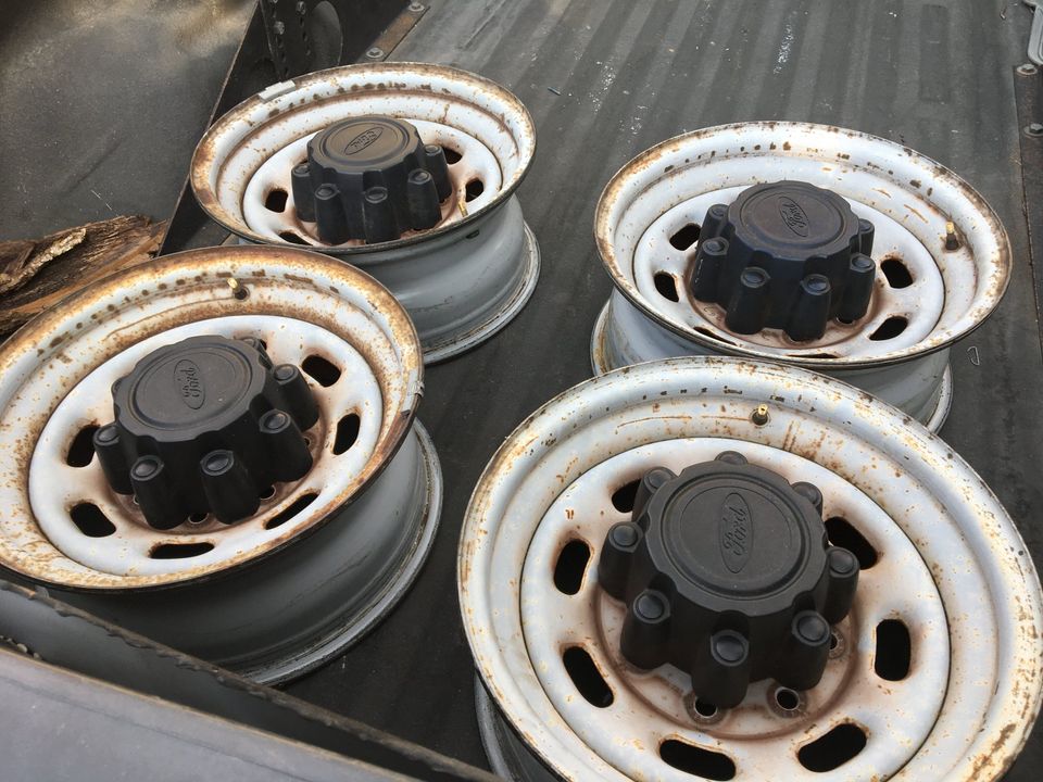

I found some factory steel XL wheels. Once I get em painted up I’ll have some Dick Cepek wheels for one of you stylish folks.

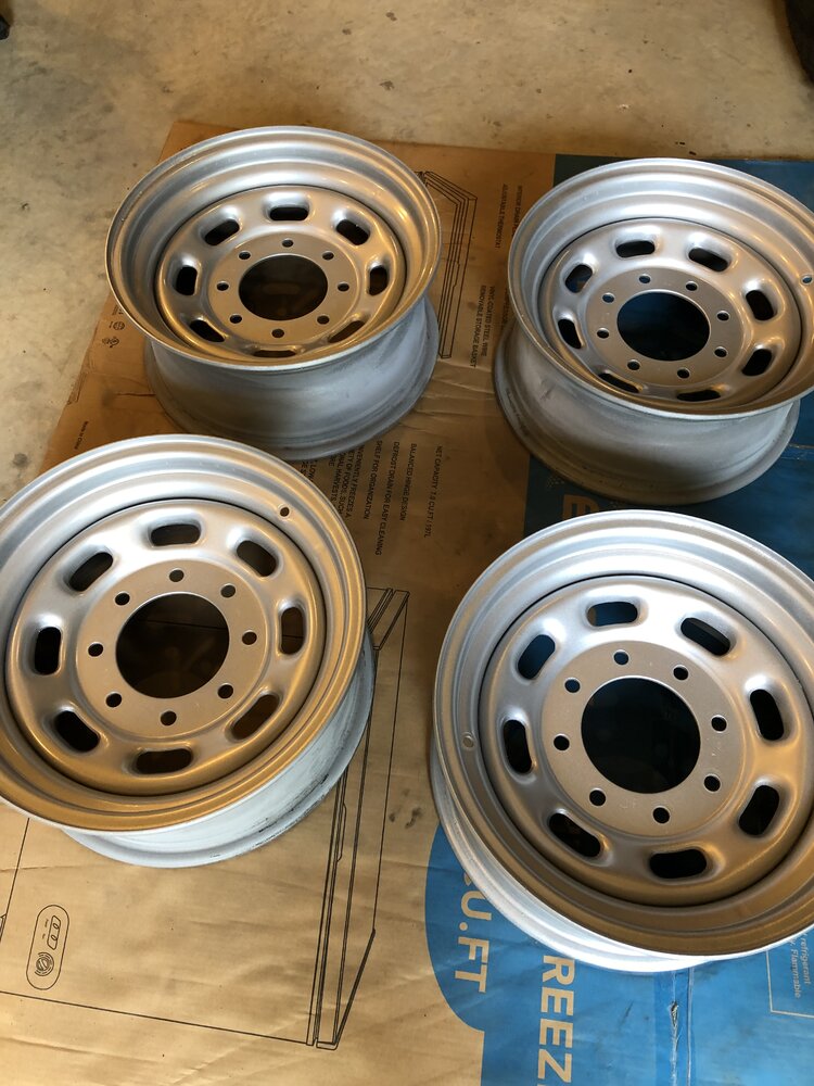

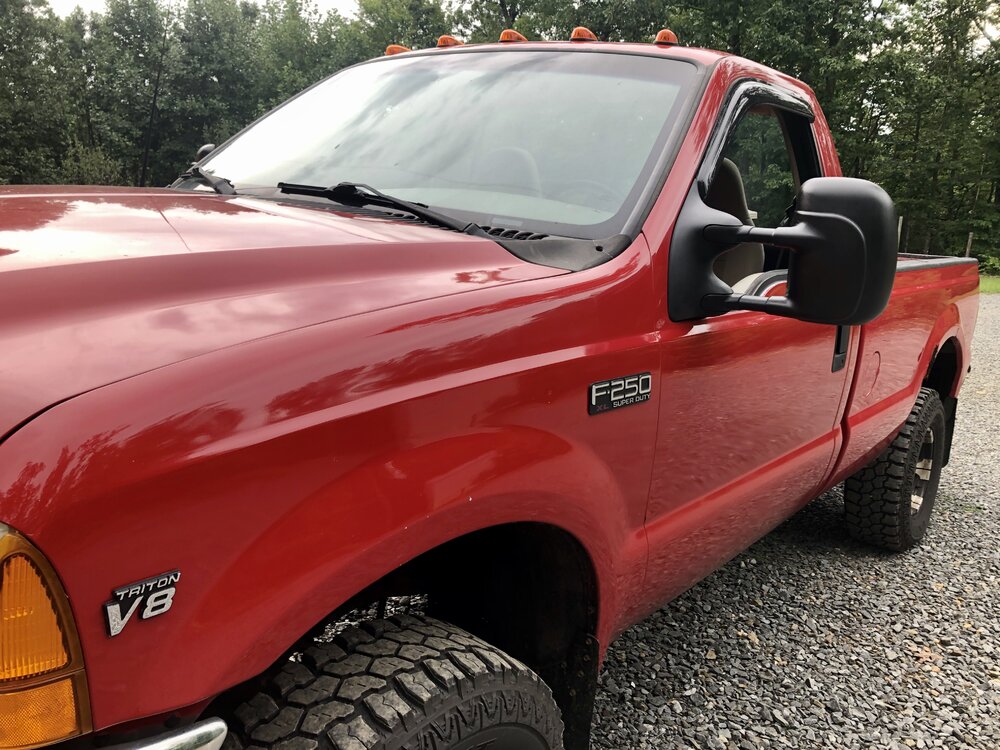

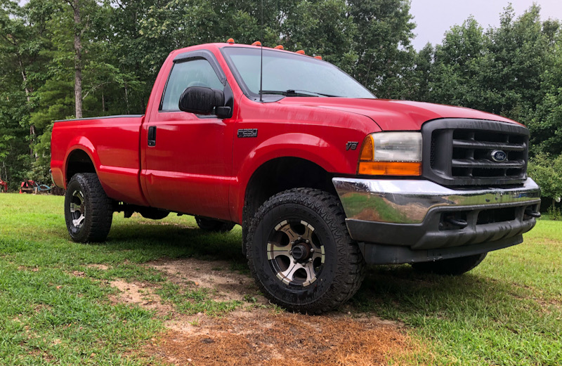

Got the wheels sandblasted at Lucky’s this morning. I then did 2 coats of etching primer followed by 2 coats of Duplicolor wheel paint in silver.
I think they look fantastic 🤠
I think I’ll paint the black center caps a medium dark gray so a little contrast without all the black.
I always liked those wheels...& regular cab F-350 4wd w/ cab lights - pretty much building my happy truck!!

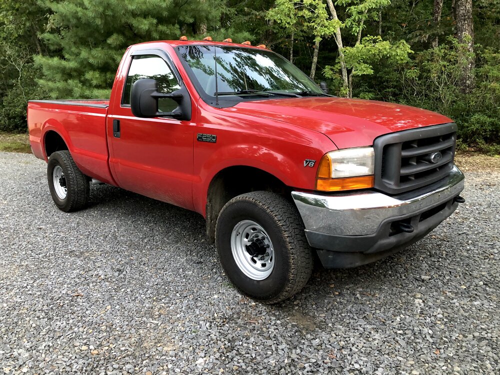

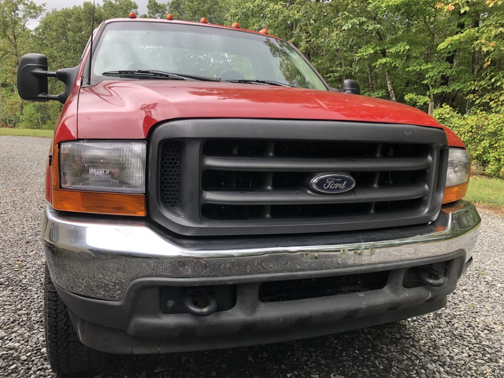

Got all of the LED bulbs installed and an electronic flasher. Looks twice as bright and is a much crisper amber. Wife says to order new headlamps because they’re cloudy, it’s a pet peeve she has.
It looks like a work truck now and not some 18 year old flatbrimwhiteoakley guy’s ride.

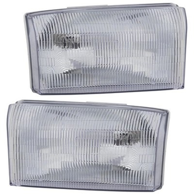

Look what I just got LOLOLOLOL
not going to upgrade to a clear lens?
I have in the past and to me the light is more scattered looking and not as even. I’ve put the clear lights in 2 previous Super Duties and felt it was a downgrade even though they look better.
Not sure where you bought the housings but plan on putting good quality bulbs in. The ones they ship “complimentary” don’t hold a candle, literally, to a good set of sylvania bulbs unless you’re looking to go LED (highly recommend).
I like the Silver Star bulbs for sure.
