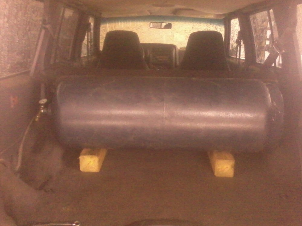

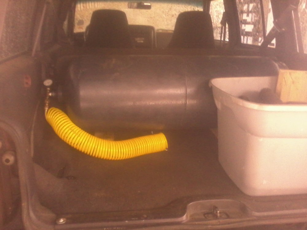

well heres the tank in the jeep for mock up:"Ghheettto" he he he..freakin HUGE:D!! but fits so good at the same time...Wednesday i'm taking the tank to have it purged and pressure tested for maximum psi and stuff for only 20bucks so that will be a good peace of mind about it. HUGE but i like it!!! :D
That sir has the potential for one badass potato cannon!
Please build a potato cannon :lol:
he he I know. i love it. probably one of the "most ghetto" things i've done but i'm like that...hey nice to have the extra weight too...between the tank and that container full of 60ft of logging chain plus parts and gallons of coolant...rides/seems to be a little more stable in the rear and not as rough so for trails should help out a little with keeping rubber on the ground maybe, lol. i can't wait to get the tank back a week from wednesday to see how much PSI it is good for..the guy thinks it will be able to safely hold 360psi...I HOPE SO! that would be some serious on board air LOL

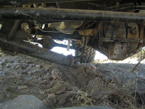

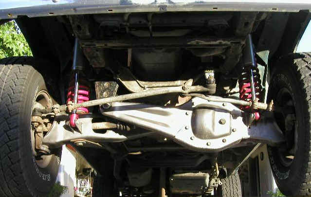

Here is the TTB axle. Its junk for anything other than stock application. Even so, its still junk.
