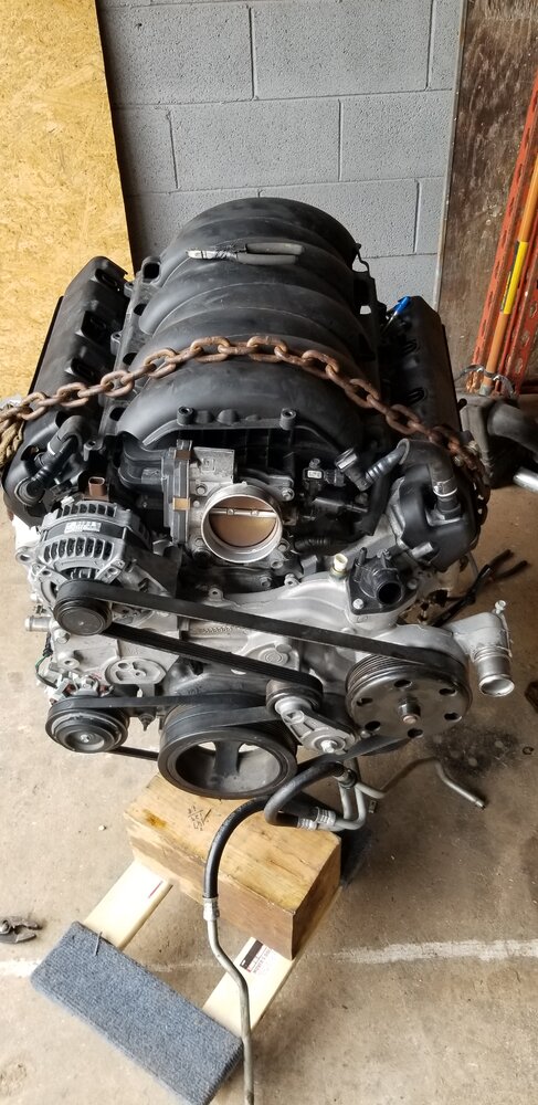

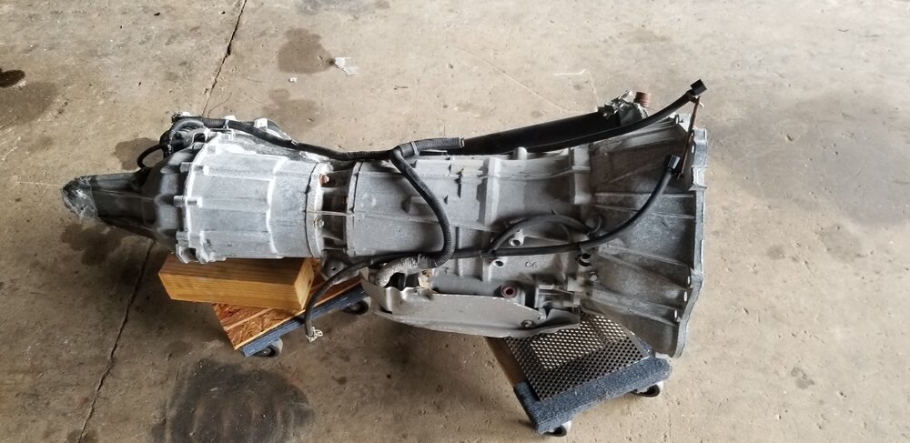

So I came back home to new customer with a TJ for LS swap. Another doctor lol from Miami. Motor came from 2018 Tahoe 24k miles, 6L80 trans, stock tcase, ordered custom harness/ECU/ pedal assembly that's coming this week so here we go. First I have body lift to put on.
He wants the Camaro ss fan, nobody sells mounts so I guess I'll be making those.

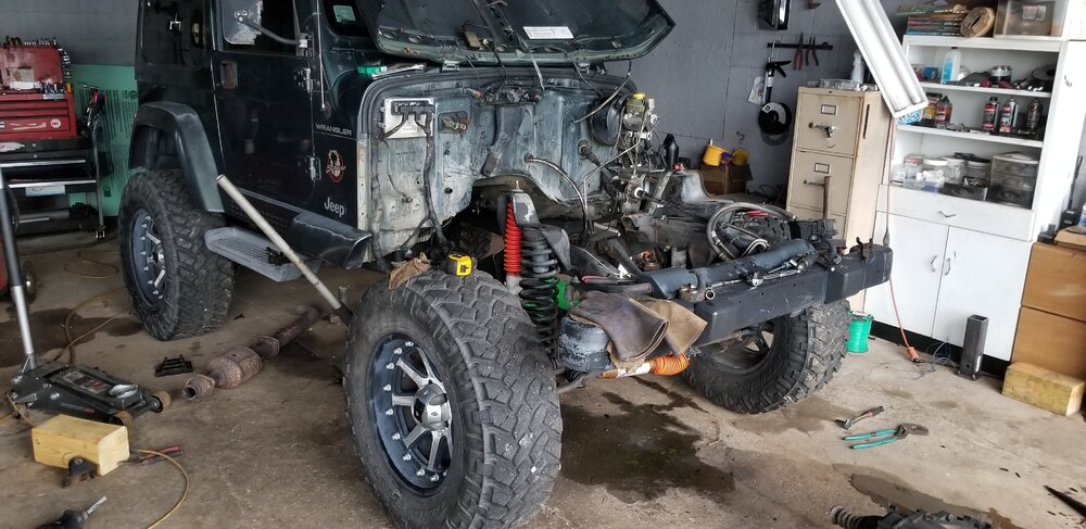

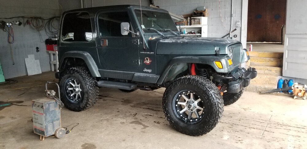

Here's the jeep, installed 2" body lift today..sweet should make the swap easier.
It's not even that. Nothing wrong with an aluminum block, but AFM/DOD, direct injection, and a 6L80E? All three of those things are probably the worst of what GM has to offer and have a known track record with having issues. MAYBE the 6L80 will survive in a Jeep, it's got to be lighter than a Tahoe. My main point was from a simplicity and reliability stand point, there were better options for a swap, but if they're to used I'd address the issues while it's all out of the vehicle. That's all.
I have no clue I'm just giving you a hard time :p
I think it's crazy that today was first time EVER installing a body lift...like WTH lol. It was pretty easy I guess, just annoying. Thank goodness this TJ has 0 rust so the bolts came right out and everything except the steering spacer was pretty smooth.

thank the GM engineers for their little connectors on this LT motor,. WTH were they thinking...to make it even harder they have some of them facing the block where you can't see what the heck your doing to unplug them...i swear them darn engineers think they so smart...took me like 2hrs to unplug the entire harness so I didn't break any sensors....which reminds me dam, this motor has tons of sensors everywhere lol
So I'm a little confused...just a little. This motor has no vacuum ports, so it has a vacuum pump at the bottom right of motor that is just a big air pump? this can be used for the brake booster, correct? thanks
Yes, that is what supplies the vacuum in the trucks. Mine has failed, which was a little scary with no power brakes. It was a recall item.

And how long is this thing compared to a 4l60?
What are you doing for power steering? Was the truck it came out of electric assist?
Ict billet setup with Corvette pump.
The 6l80 isn't longer its bulkier and heavier though lol

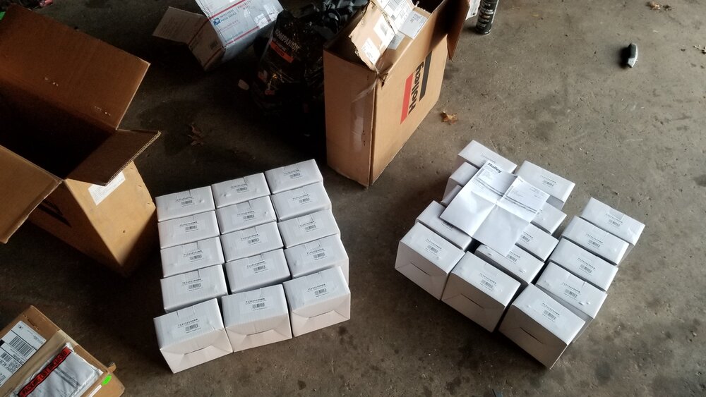

Guys I've heard of screwing up an order but daiuuuuuuuuuuuuuuummmmm somebody gettin fired from Holley!!
He ordered and paid for 1 LT1 swap motor mounts and I get 2 boxes full of 30...yes that's 30. What in tarnation.....bye felicia
Their screw up, your profit.
