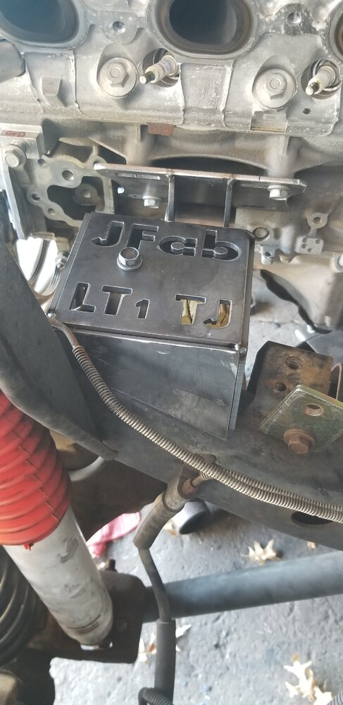

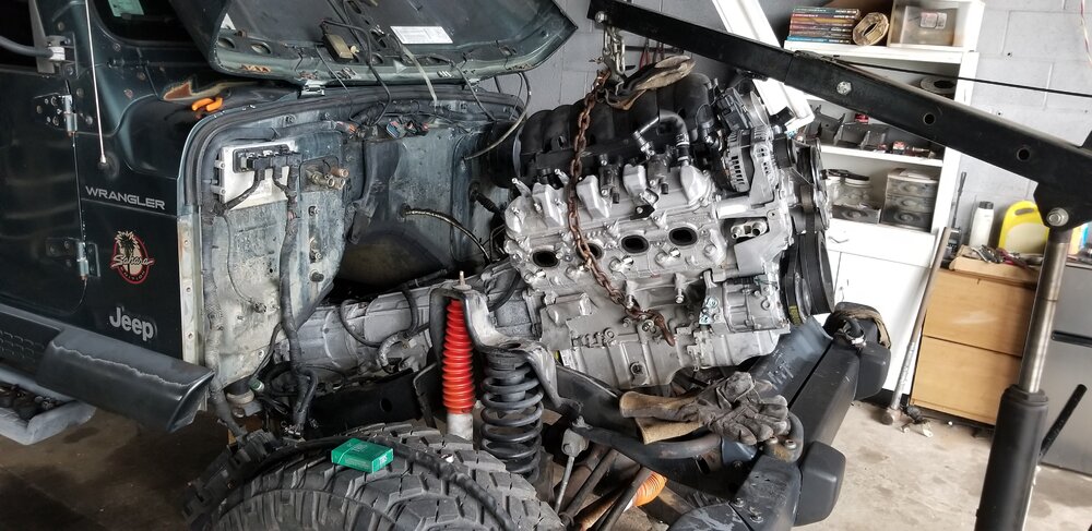

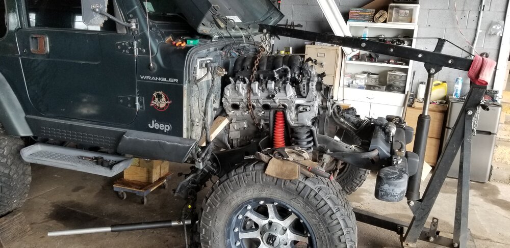

Getting some progress..motors ready to get some mounts made. I'm going to also make them on CNC table so I can offer these Gen V swap mounts very affordably! Stay tuned..
I've got tons of parts in for this thing, motor mounts are almost complete so just about ready to go at it hard in the next week or so. Been crazy busy with stuff (and I'm slow with designing lol)

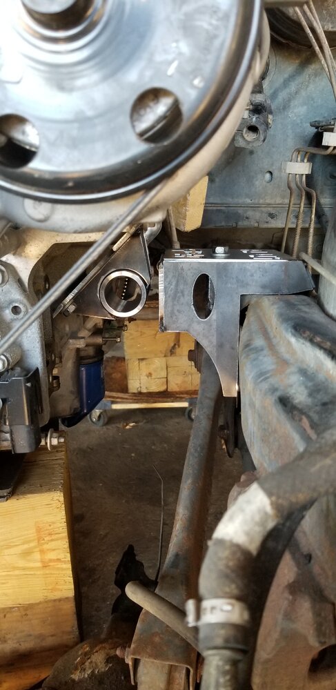

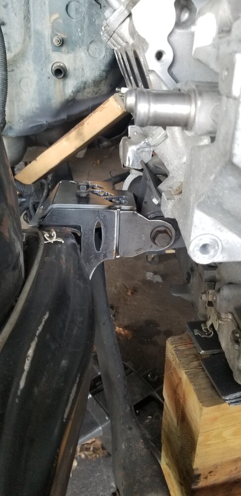

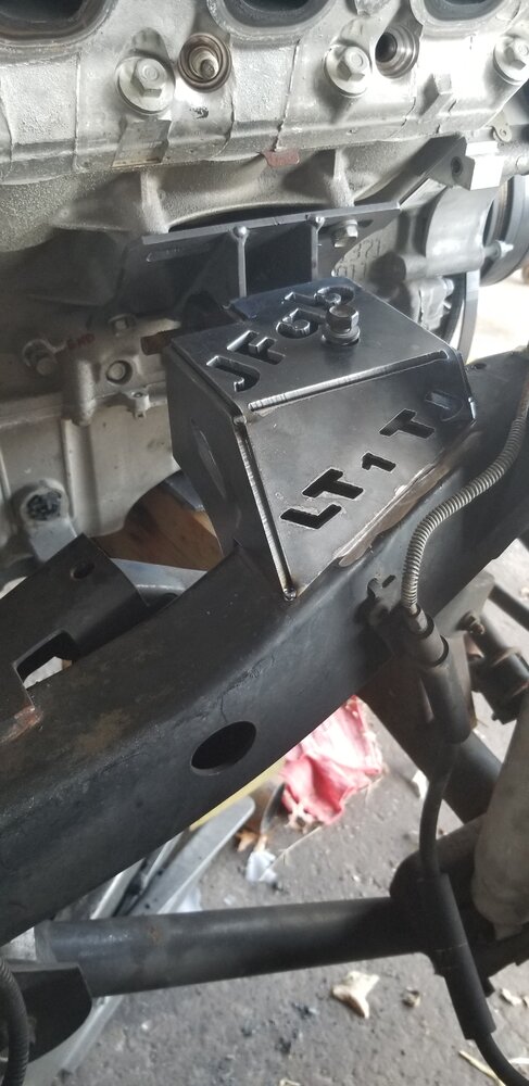

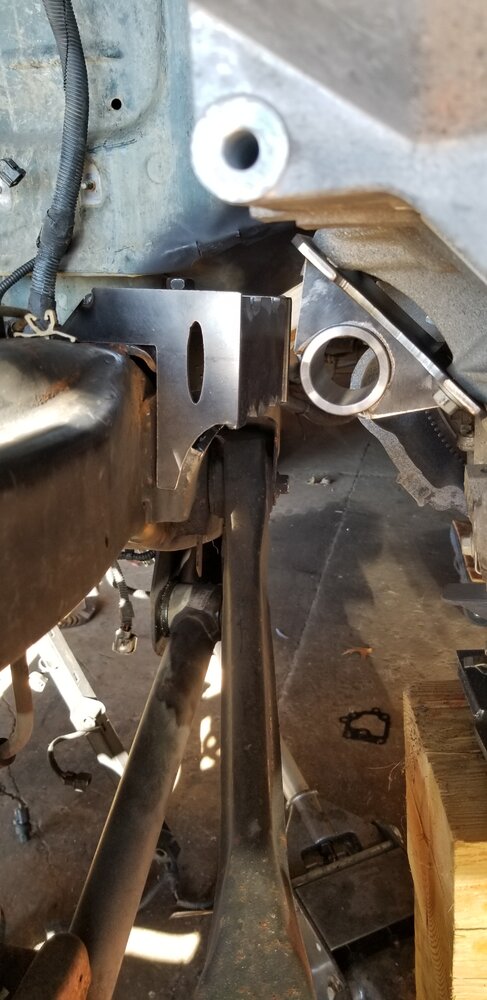

TJ L83 5.3 swap mounts done!
Nothing fancy but easy to install, no guesswork!
Been so busy and behind schedule but they're perfected after several times tweaking.
Will be posted for sale soon. Bolt in to factory mount hole to allign, then weld em in. Starts with motor 1/4" from firewall/ tub and allows 1" forward movement. Sets the 5.3 about 3/4" to passenger side, no modding of steering shaft!
Huh....would you look at that? Would you just look at it?
A far cry from square tube exo cages with no triangulation and whatever else this crowd used to mess with you about.
Keep on keepin' on.

Thanks buddy. I think I spent a little too much time making/perfecting them but it will be worth it I think (I hope)
