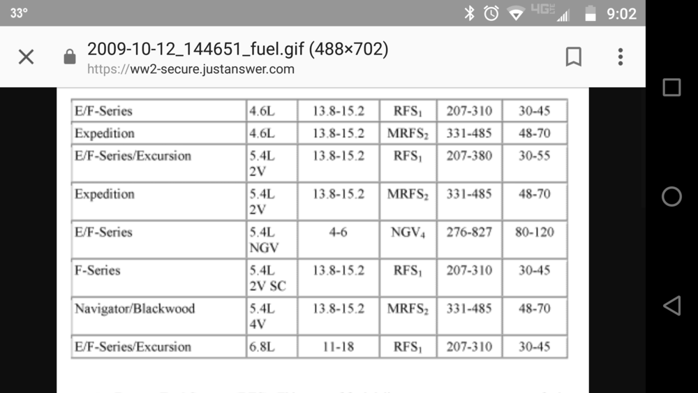

Hey everyone, could someone please verify the proper fuel pressure for this 2003 Ford Expedition 5.4 L I'm getting mixed results on the web between 38psi and 65psi WTH? Mine is 55running, 58 when giving throttle. It's my last test to find this stumbling it has. It bucks/hesitates under light throttle or mostly notice in OD otherwise runs fine. Only codes are lean codes for both banks. Thank you.

Thank you sir. All new coils, plugs, vacuum hoses/fittings, sprayed carb cleaner everywhere and nothing.
All 4 O2 sensors show same voltage as the others (none of them are off reading from the others). Long term fuel trim 2 is way off, other readings are good.
