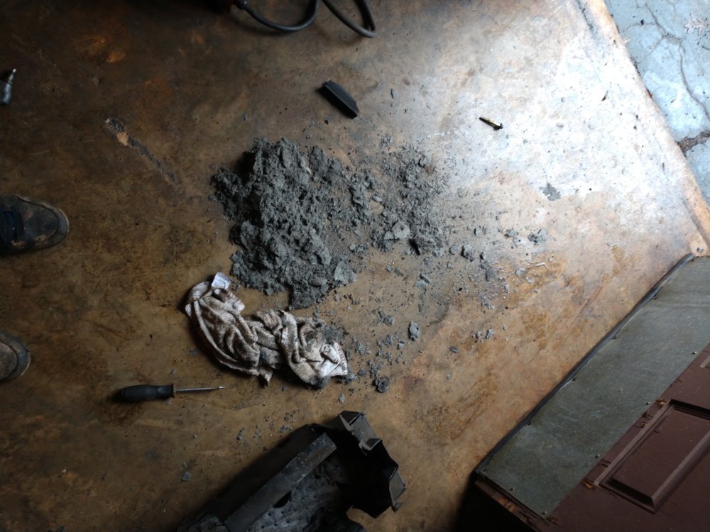

What the heck is this pile of crap that fell out everywhere when I removed intake and is it bad. Do I have to get/put insulation back under it..if so can it be regular house R34 insulation

WTF is that? Is that silt from a flood?
Lol no it's some foam insulation stuff on bottom of intake..it fell everywhere when pulled it out.
