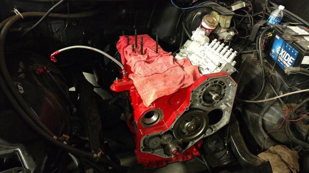

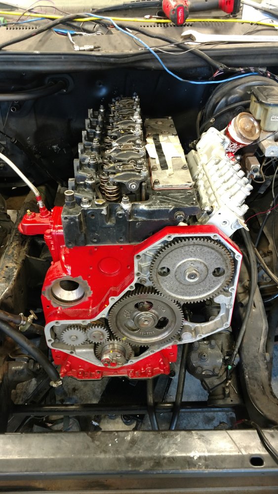

After a mishap with my engine builder I am finally going together with it the larger cam has to have 24 valve tappits my engine man put 12 valve tappits back in witch is taller then 24s so out with the cam and in with new tappits

The tappets aren't different heights, they're different widths. The shoulder appears shorter, but the point at which the pushrod sits in the cup of the lifter is almost identical to the OEM 12 valve lifter. Close enough in height to use the factory length push rods.
I used them (24 valve) when I did my cam swap as well. The width helps them ride over the lobe of a more aggressive cam without trying to dig and also gives it more wear surface for oil to get under, which helps it last longer.
I think you need to put twins on it and let your girls drive it to school every now and then :popcorn:....
The tappits are 75 thou shorter on a 24 with the work that has been done to the head and block I could not run them the lash was to tight
If 24s are shorter, how is the valve lash too tight?
For real though....there's a LOT of adjustment on the rocker arms on a 12 valve. Besides, why would he go through the trouble of pulling the cam and tappets back out to run a narrower tappet on a more aggressive cam lobe instead of just measuring for new push rods?
How much was the block decked? And how much were the heads surfaced? What thickness is the head gasket? There's got to be a drastic change if you ran out of lash adjustment on the rocker arms.
The lash was to tight with 12 valve tappits in it now that it has 24 valve tappits back in it is fine when I get another 24 valve tappits I will take a pic with a 12 valve tappits and a 24 valve tappits side by side with the same length push rod in them and a straight edge across the top and show the difference. With the head being shaved and the block decked to raise the compression I don't have much adjustment left for stock push rods
That's why I asked how much it was decked, how much the heads were surfaced, and how thick the head gaskets are. All of that obviously changes the distance between the tappet and rocker arm.
I've seen the 12s and 24s side by side. They have a different overall height, but the pushrod cups are very close to the same height from the face to the cup, but since the cups are made for a larger diameter on the 24s, the pushrod can sit a little lower in it.
The way it was worded, I thought he put it together with the 24s and took them back out to put in 12s. That would have been asinine! :D

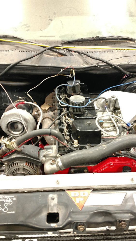

Had a good day today fired it up with the old header and 64mm turbo to get the cam broke in check for leaks. Speed steed header and spool flange will be here next week that gives me time for some much needed wire management.
