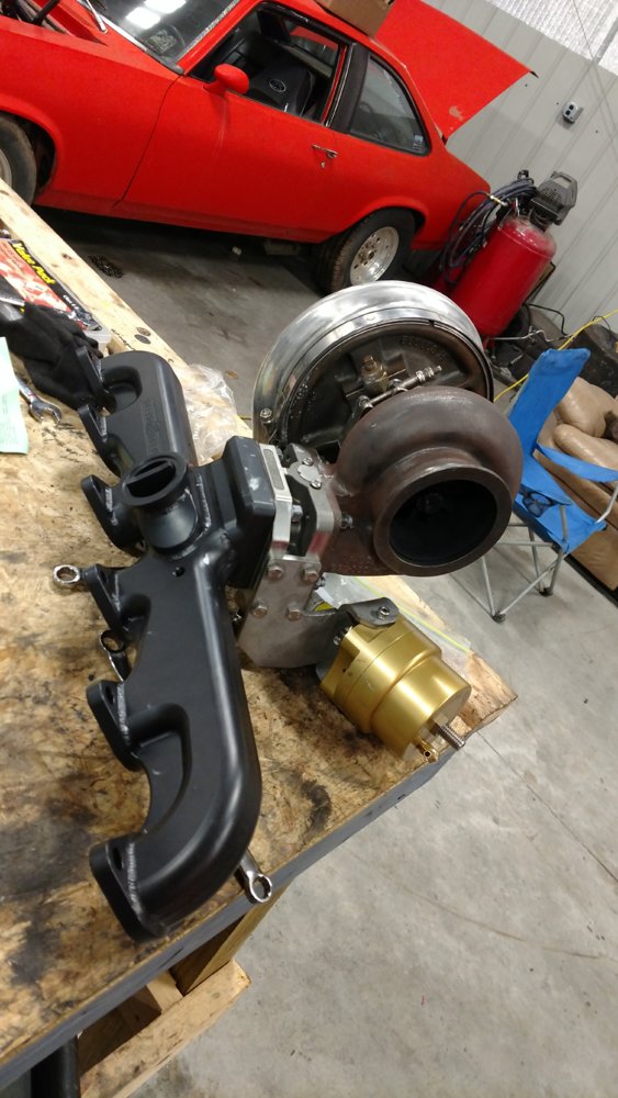

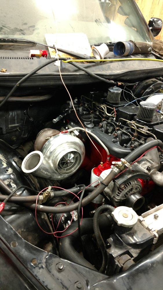

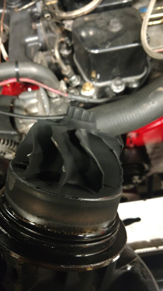

For a small update went and got some nos today at a race shop in another county had plans to take it slow change the oil double check everything and get ready for some tests at shady side no big deal. About 9:30 pm or so got a call from the guy i got my nos from asking me if i wanted to play not going to back down i told him to come on i wanted to race with out nos he wanted to race with nos . So 2 passes to please both of us the first pass it pulled 5 trucks on him the second i told him to spray me if he wanted to but it's was not going to the road wouldn't hold what is had it was already a peddle fest he did and i got him by 2 or 3 but it costed me a turbo. That's one monkey off my back 2 wins.
Not sure had air filter and waste gate was set on 60 lbs i have been driving it for over a week now change the break in oil last night. The truck was at driving temp it just let go towards the end of the second past egts was good for what it is somewhere around 1400 F* so don't know
You got nitrous, you sprayed nitrous, and the nitrous blew up your turbo. This isn't the fast and furious. NOS is a name brand that sells nitrous kits, not the funny gas in the baby bottle.

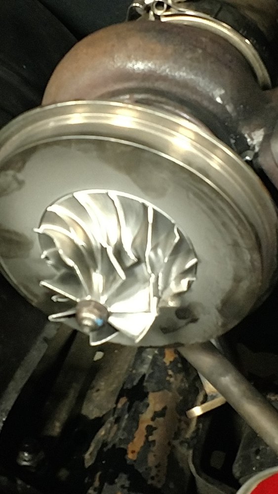

That seriously suck about your turbo. Did it just take out the wheel or the whole thing?
Found the problem the boost reference tube for the spool flange blew off and restricted the turbo to one port if i had to guess the heat was to much for the exhaust side melting the tips of the fins throwing the wheel out of balance taking the bearings out and the rest is history. The intercooler seams to have caught the fins hopefully all is good everywhere else. I am glad i spent the money on a waste gate instead of blocking the port off that probably saved the motor.
