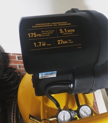

I use the 29 gal HF compressor as I didn’t want to add another 220 plug for a 60+ gallon unit. It’s stated at 5.9cfm @ 90. I have 8 running hours so far on the motor and it has run my 30amp plasma well through a motor guard air filter.
29 gallon 2 HP 150 PSI Cast Iron Vertical Air Compressor
I have switched my other air tools over to Milwaukee including their new M12 right angle die grinder which has been great.
Edit to add, from my research a few months ago, I could have gone to the 30 gallon Kobalt 120v compressor (highest compacity I found in 120v) or the next jump in 120v is to the Eastwood scroll compressor that gives outputs similar to what you’ll get from a 60gal tank. It’s a horizontal 30 gallon unit on wheels but super pricey.
