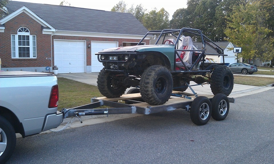

Looking at a 7.5'x12' trailer. Made from 6" C-channel all the way down with 4"angle braces, dual mobile home axles. Guy says its beefy and he's hauled several jeeps on it. So I figured should work great for my crawler.
Any input as to why a 12ft would be not so good other than no extra room for other stuff? Thanks, and Merry Christmas to all!!

Think about anchor points for straps. At 12ft you have NO room to properly tie down that load (unless you use auto transport type tire straps)
Mobile home axles and tires suck. 14.5" rims, the tires are bias ply, and the mounting tabs are a pain.
It doesn't sound like it's long enough to get decent weight distribution and good tongue weight. I could be wrong since I've never seen the trailer. If I'm right then that would lead to a "tail wagging the dog" situation and that never ends well.

That was my main concern is weight distribution. Tie downs easy fix but the placement of jeep ....hmmm
Ok stupid ? But can you add couple feet to a trailer? I have access to big welders and stuff
It's hard to add length to a trailer in the proper place without basically rebuilding the trailer. At that point, I'd just look for a longer trailer to start with.

IMHO, I disagree with this statement. I strap to the axles and you can always run the straps in to a tie down point between the front and rear axles. X’d of course.
IMO, that's not a suitable trailer for towing a rig around. I feel it is too short and not built to carry 5k# around safely.
In all seriousness, the cost of even a new or gently used CAR hauler or equipment trailer is a wise investment to keep you and your cargo (both in the cab and on the trailer) safe.

Along with all the above info, I believe the mobile home axles or at least the rims, are illegal for trailer use. And being that is what he seemed to use, along with home built, is their a Title? Weight distribution can be a problem, & is your Crawler Really only 12'? I haven't kept up with your build. The Only similar situation I recall, is a Club member that could haul his near stock Samy, on a 12 or 14' single axle trailer, Safety.
I built a 12’ trailer to haul my yota. Crossed the straps towards the center of the trailer. It pulled great and the yota (110” wb) fit perfectly. I did the weight calculations and used dual 3500lb braking axles that I got from Kaufman. I’m also not a fan of the mobile home/Hudson trailer type rims.
Edited to add that IMO a 12’ trailer will work, just not THAT 12’ trailer. Between the MH axles and the sellers admittance of instability - stay away (as you said you will do).
