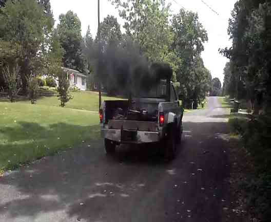

Whew, alot got done today, I pulled the motors out of two trucks, one was the 12v donor motor, the other was a 24v out of a 01' that I am using the NV4500 out of for the bus. I did make some time to put some junk tires on the 91 for one final run, I will post up the video in a bit.
