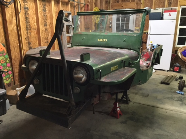

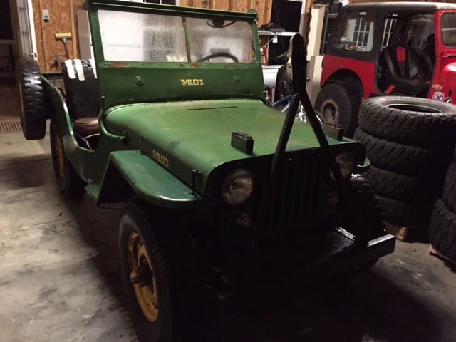

It's been about 4 or 5 years since I've built anything, but I picked up this CJ-2A not too long ago. A nice barn find, it has the original 134 F-head, T-90, and Dana 18 case all in good condition. I got it home, got it running, then started taking it apart! The hat channels on the underside of the tub have rust, as do the rockers and some pin holes in the back of the tub, but it's slowly getting fixed some way or another.
I got some aircraft stripper and started going to work. The PO painted it the factory green with yellow wheels, but the tub says different. It was originally red. I'm looking to go back to red.

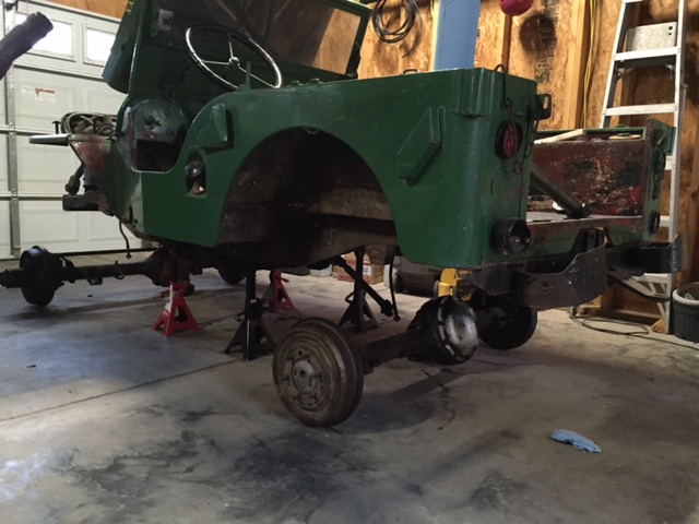

Both the driver and passenger steps were pretty cancerous, so I went ahead and snipped them out:

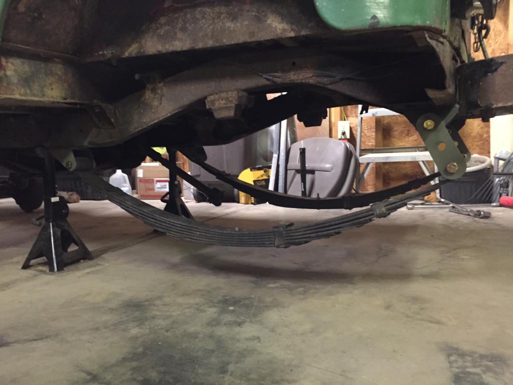

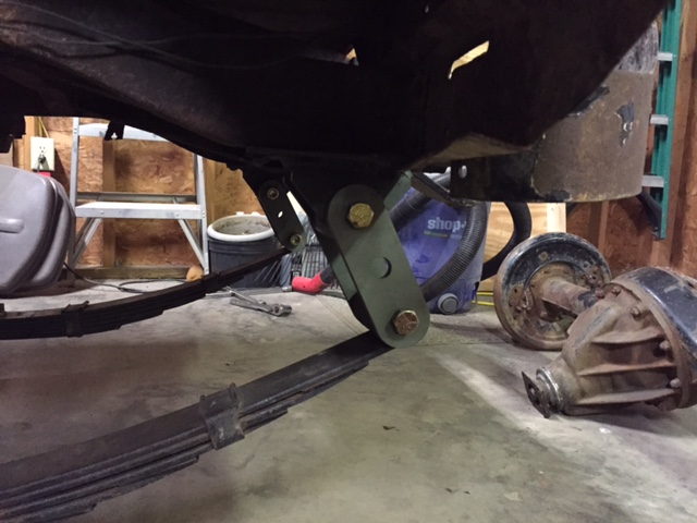

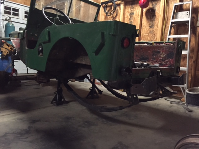

I decided I want to use wagoneer springs in the rear in SOA configuration, and a 3-link with coils in the front. I picked up some Rubicon coils for the front and started cleaning off the frame.

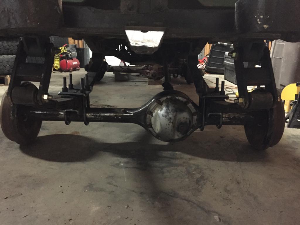

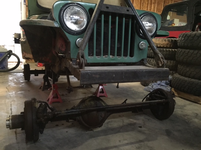

Went up to ECGS and picked up a set of factory FJ40 axles. These axles are perfect for the build. A nice width that won't look goofy wide, great strength with a 9.5" ring gear, and the rear has the offset diff to match the Dana 18.
The brackets for the front and rear suspension will be coming in the mail soon. Stay tuned. I've got the FJ40 axles stripped down and bracket-less now, just no pics. There will be pics to come. For the curious, I want to keep as much body, frame, and drivetrain as the build allows while having a nicely built flattie that can be a driver or wheeler.

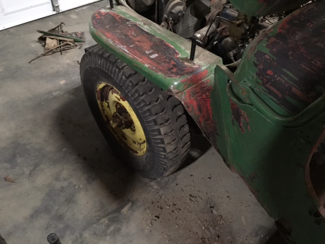

The pictures from when I picked it up are probably a little misleading. The paint looks good from 30 feet, but there was more body filler on the passenger side than was worth saving. Same goes for the rockers, etc. I'm all for original restorations, but it would be prohibitively expensive for me at this point to do a full restore like it would need. I'm hoping the work I'm doing will preserve it more than anything, while making it usable.

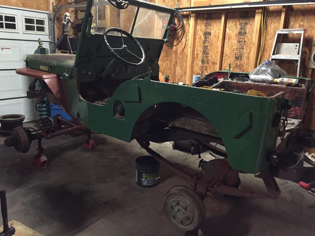

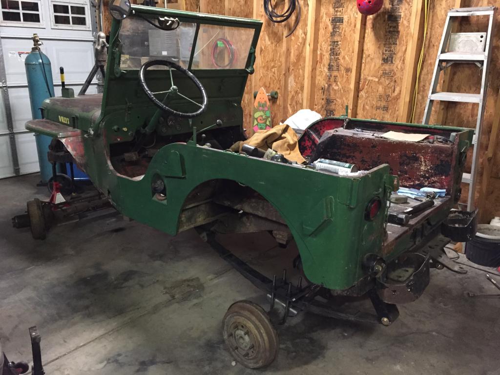

Nothing yet other than cutting the spring brackets off and trimming the fenders. I cut the step off and cut the back part of the flat fender at an angle.
Got some ssssprangggs on tonight:
ai212.photobucket.com_albums_cc116_336wheeler_IMG_0285.jpg .... that driver side jerry can holder needs some bolts :flipoff2:

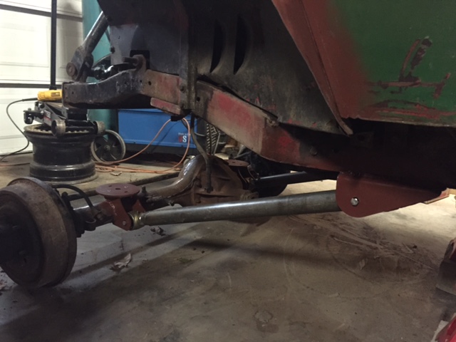

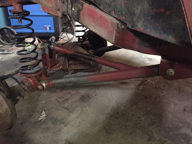

Happened to have some down time today so I got some work done. Got the radius arm front burned in except for the panhard bar. I'll need more heims/brackets for that endeavor. All brackets are from Ruffstuff by the way. Wheelbase ended up at 94". Looking at 8" pushed out in the front; 6" pushed out in the back.
Nice work! Looking forward to following the progress of this build.. I've been on the hunt for a willys for a while.
The springs on there currently are factory rubicon coils. I am going to play around with stock coils and it should drop about 1.5".
I can probably round up some JK coils.

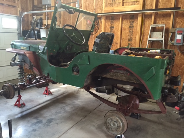

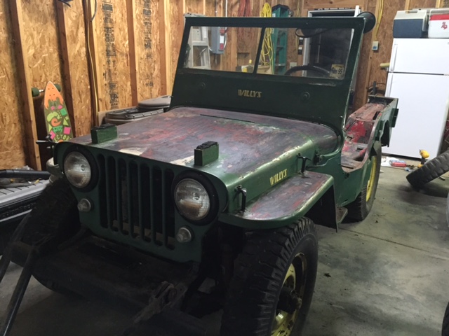

Did some fender trimming, then put the seat back in so I could sit in it :rockon::
