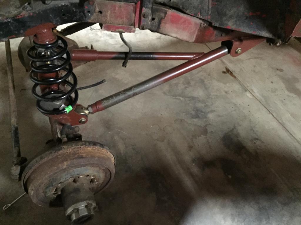

Swapped in rear JK coils to the front. They are pretty smushy and fit my coil buckets well. Got my panhard brackets - will be getting into that later this week. Maybe some steering too ?!?

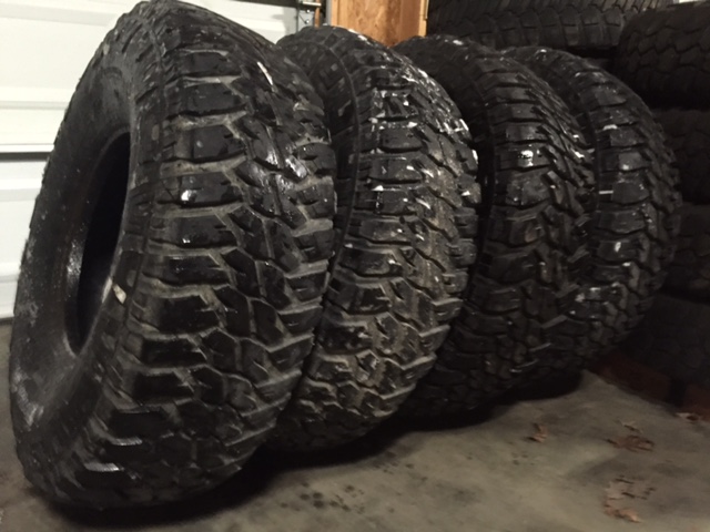

Picked up some 37" MTRs tonight for this thing.

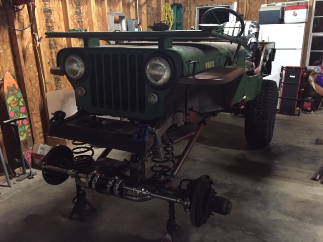

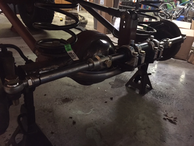

Got the full hydro mounted. 6" double ended TG full hydro set-up.

Frame end panhard bracket and axle end panhard bracket are on - just waiting on some parts in the mail to show up and the suspension will be done!

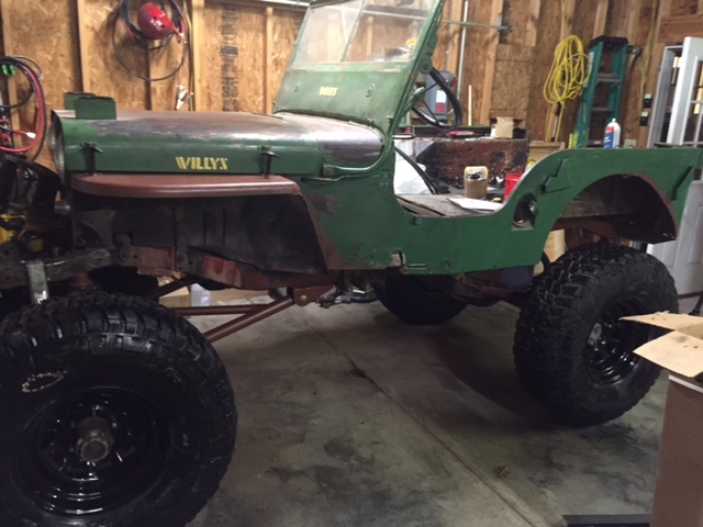

The jeep as it sits now (don't mind the angle iron, it's holding the body together :flipoff2:):
So what started out as a neat resto-mod build with a 4 cyl turned into a SBC chevy buggy build. And that's alright with me :D The goal is to be sub-3500 lbs when complete.

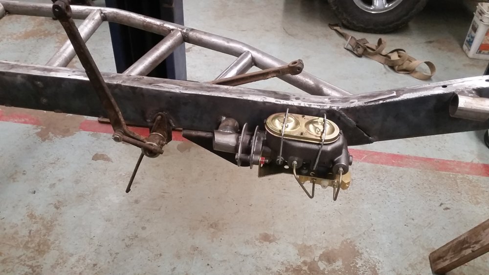

I was wondering if @ChrisM was doing this one. He mentioned to me a while ago he had a Willys he was working on. Have you reworked the floor area yet? What are you going to do for pedal positions? Using the original steering column?
Made this MC bracket to run original pedals. Planned to do something similar for a hydraulic clutch. This has since been cut off as it was interfering with getting the 350 where we wanted. I have an idea to mount the MC "backwards" with a pivot point for the pushrod, but at this point, pedals will be figured out later.
