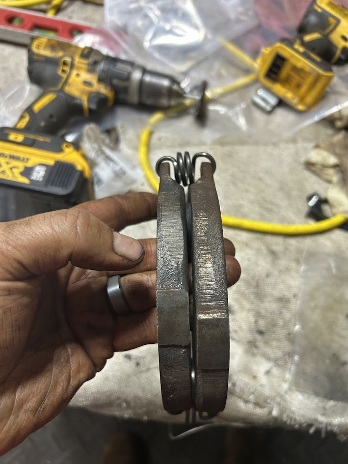

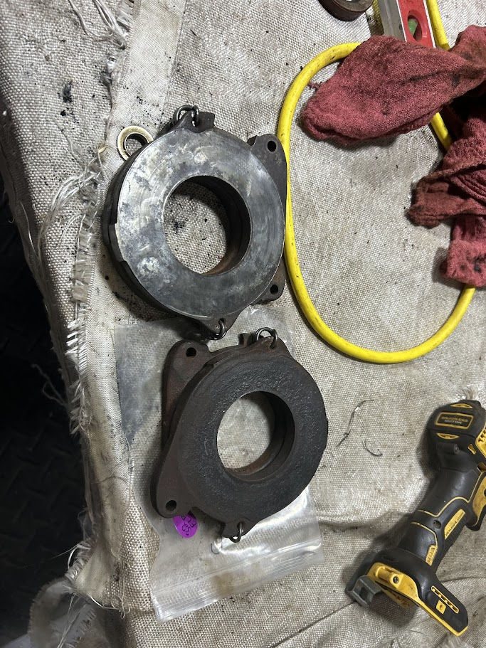

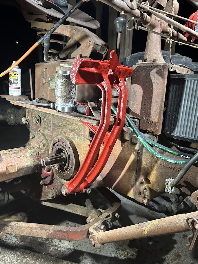

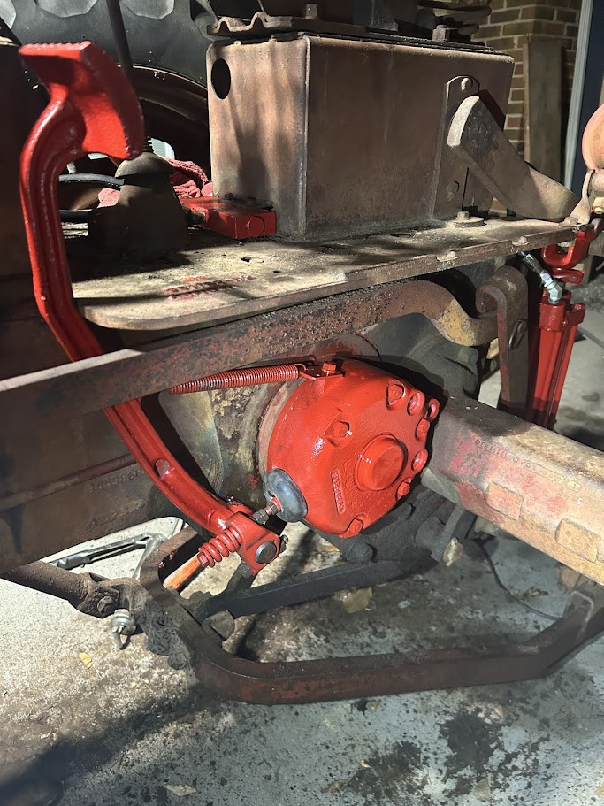

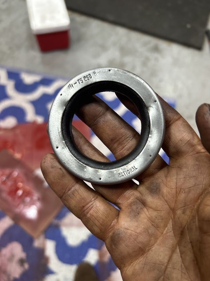

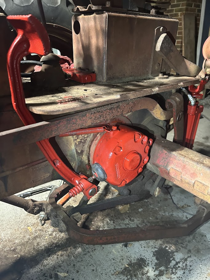

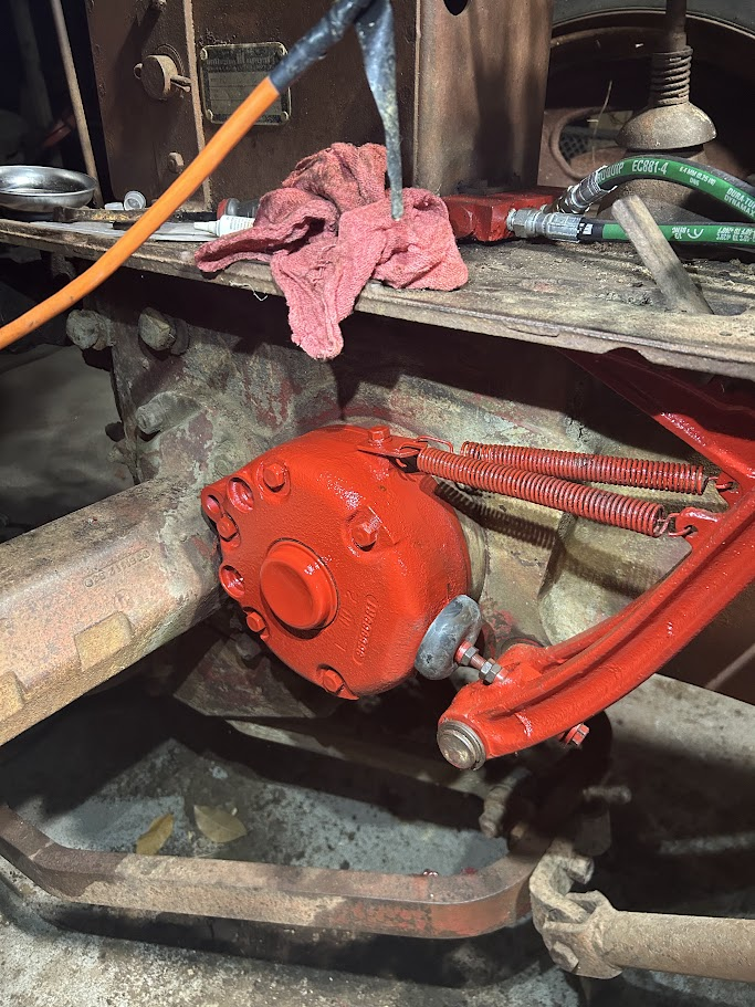

Parts order came in for the brakes. Either I messed up ordering, they sent me the wrong parts, or there are different size oil seals for the brake systems. However, I was able to reassemble the ramp plates and balls, get everything lubed and put back together with new springs.

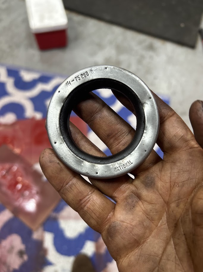

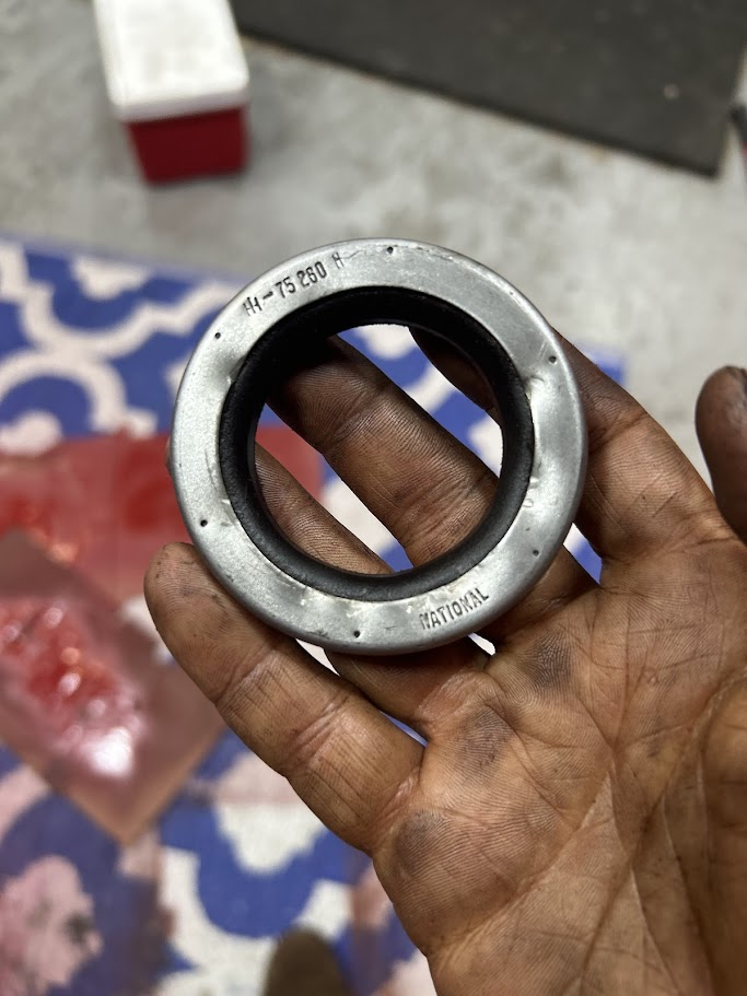

I was able to cross reference the original seal with an O'Reilly part number for the oil seals. Should be here Tuesday morning. Original oil seal:

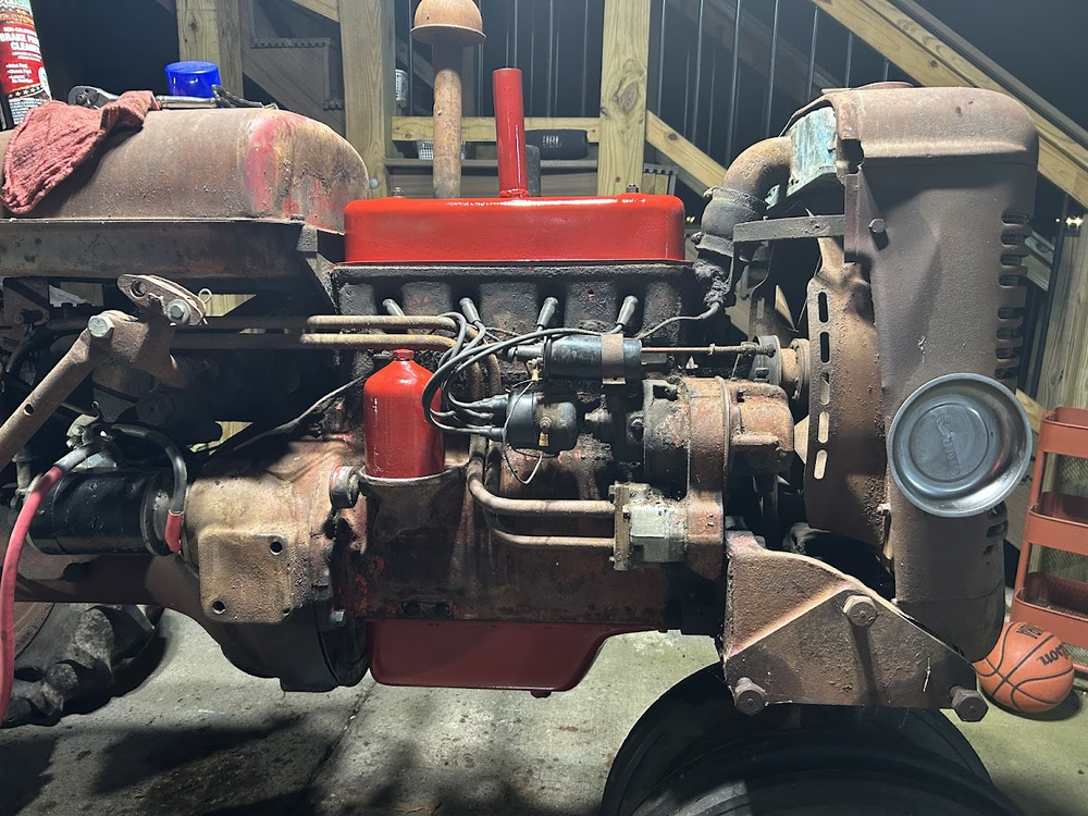

I was able to reseal the oil pan, valve cover, and oil filter. Running 10w-40 Rotella. Filter is readily available at O'Reillys.

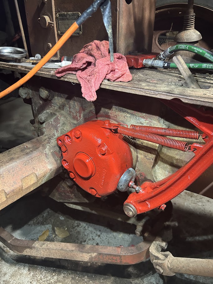

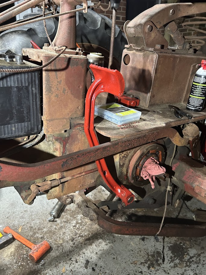

Also got the brake pedals/clutch pedal back on. Hopefully I can button the brake system back up this week.

So are you gonna paint the whole thing or just the brake pedals? :laughing:
