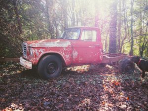

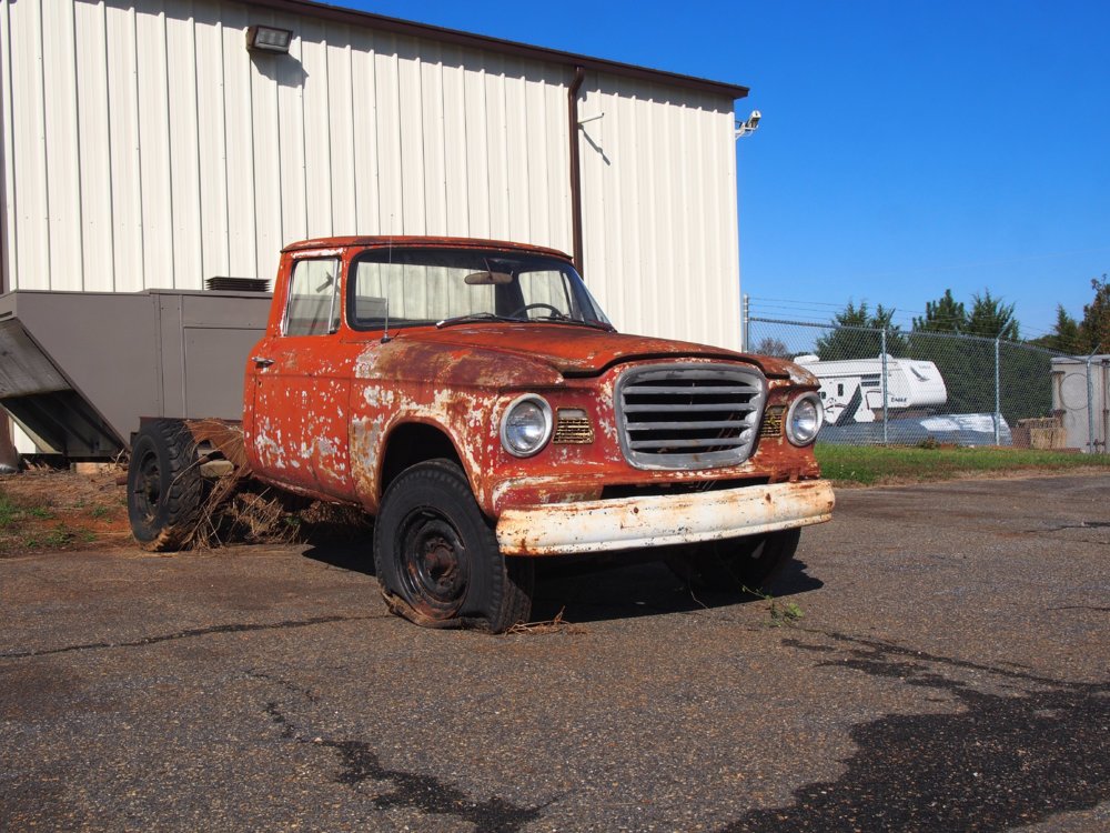

Hey everyone. I picked up a 1960 Studebaker Champ 3/4 ton from the Bay of E for $450 as a base for my girls daily. The floors are rusted out, but the rest of the truck is pretty solid, it has the original driveline, and factory D60 rear (4.27 gears).

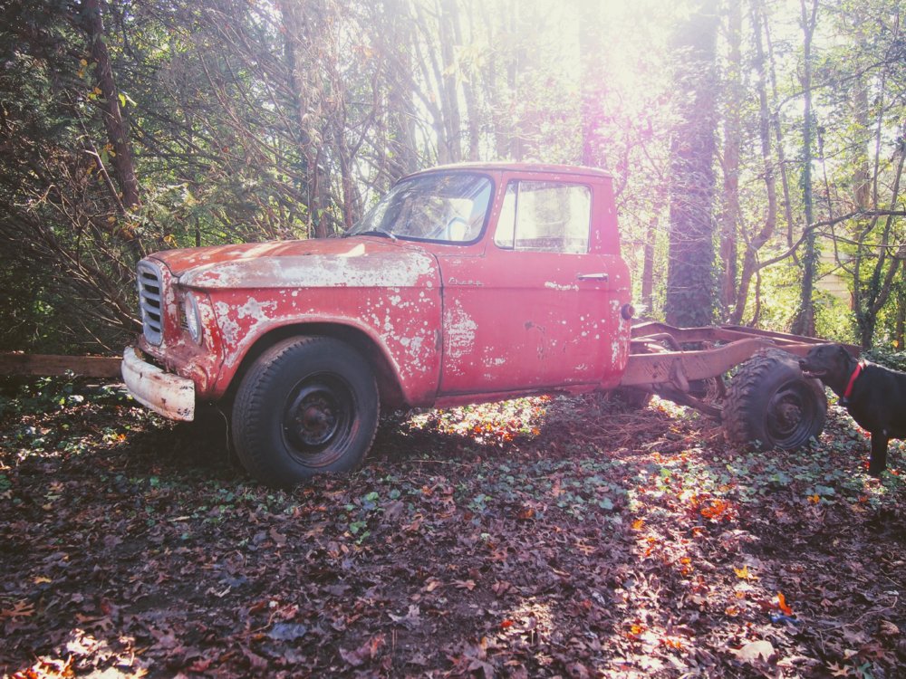

Here's Stew when I picked him up Saturday.

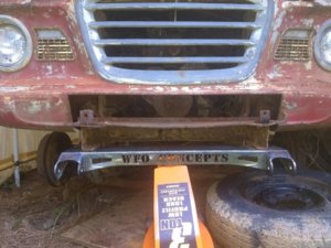

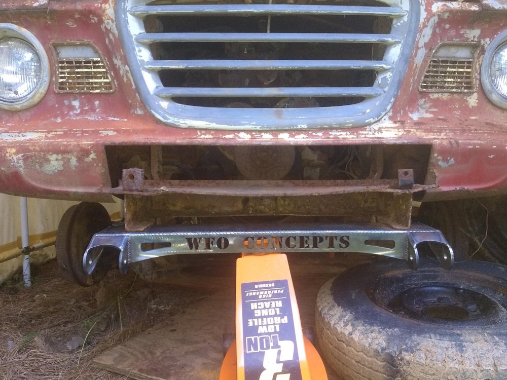

So stoked, the WFO low & stretched hanger arrived today! The damn thing is made of thicker steel than Stew's frame.
(Side note: I'll need to do a lot of boxing on his stock frame to keep it from twisting apart.)
Pic of the hanger even with the front of the frame rail. This gives the full 1.5" stretch, and 2.5" drop. Now I can measure for springs (I still want to use FSJ 47.5" fronts), measure shackle placement, etc, etc..

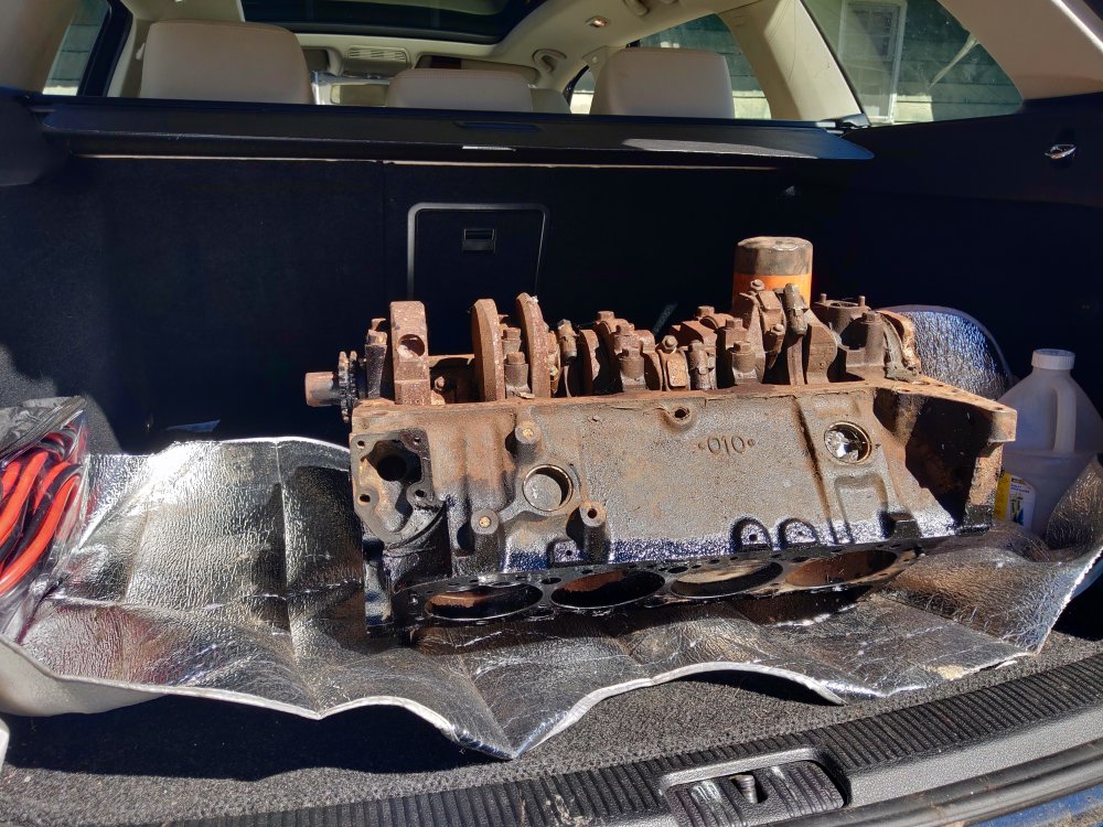

Update on Stew. Picked up axles last weekend and dropping off two engine blocks for machining tomorrow.

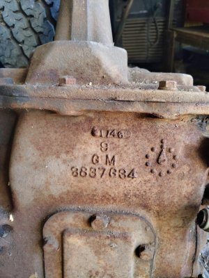

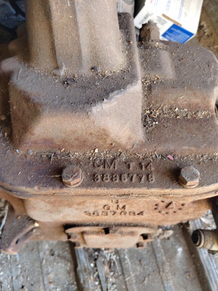

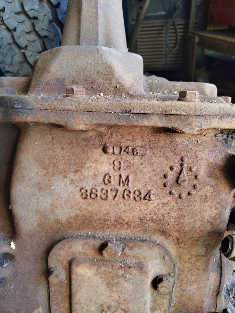

My Pops is cleaning his shop and offered a SM420 he had laying around, so that may end up in Stew depending on it's condition. Also grabbed another SBC 350 010 short block that will be a "cheap" build.
